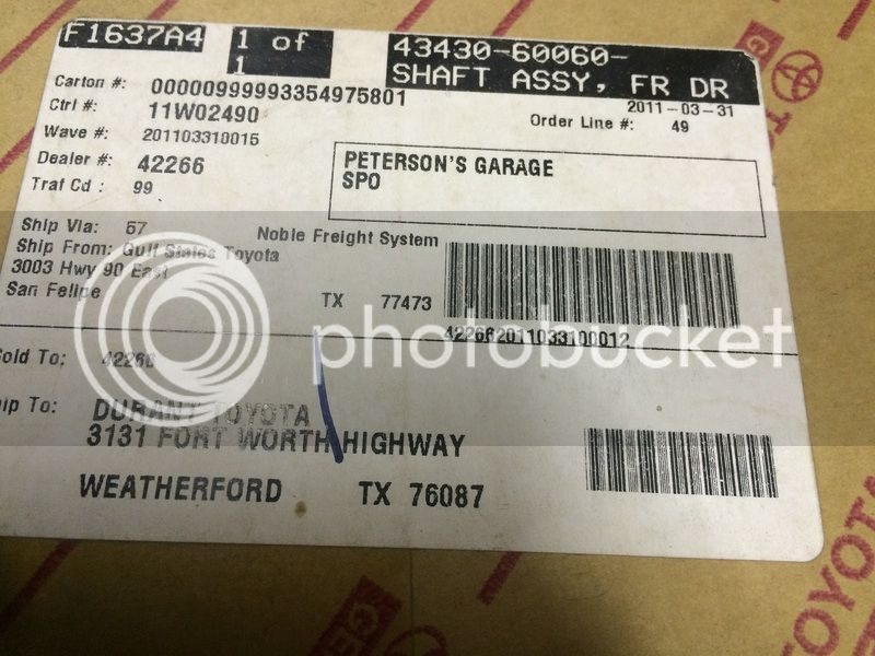

I'm on Toyota of dallas and looking for complete CV axle assembly.......Can anybody confirm below part #s?
Also, obviously the same for both sides, I'd imagine......Thanks again to everybody.
2007 FJ
CV Axle Assy - 43430-60061 ??? (Lady on phone sounded less than sure......)
Diff Seal - Passenger - 90311-47013 ???
Diff Seal - Driver - 90311-47012 ???

CV shaft Assy is 43430-60060 for my 2007.

10-4........Yeah, appreciate it. Keeping my other that's not destroyed to reboot/rehaul and keep as a spare.......That is, assuming the 43430-60061's I listed above DO actually fit!!!!!!!
