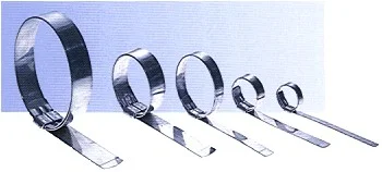

The search was on for a better clamp that I have used in the past on different vehicles. The OEM clamps are "fold over" type that has one closed diameter, and cannot be tightened any more than designed. I found some "crimp style" clamps in the 38-40MM size that I have the tool for. This is where the cost can creep up for the DIY guy, unless you like buying tools and can use them later.
So far I'm at 12K miles after re-clamping the boots, and they are nice and dry now. Hope this can help those fighting grease spots all the inner fenders.
Here is the type of clamp I used.
And here are the crimping pliers yuo will need to tighten this type of clamp.

I found these clamps at a NAPA Auto Parts store and clamped them right over the old boots. That is one HUGE advantage for them as they open up and you don't have to disassemble the axle. Just have some good side cutters to get the old clamp off.

I did check at NAPA and they did have some clamps ($2 or so) -only 2 sizes but lots of adjustment room- and pliers ($30).

Jeff, does that crimping tool ALSO tighten the clamps? It seems that it'd be important to get a tighter seal than stock to really 'solve' the leakage problem. Ghost
