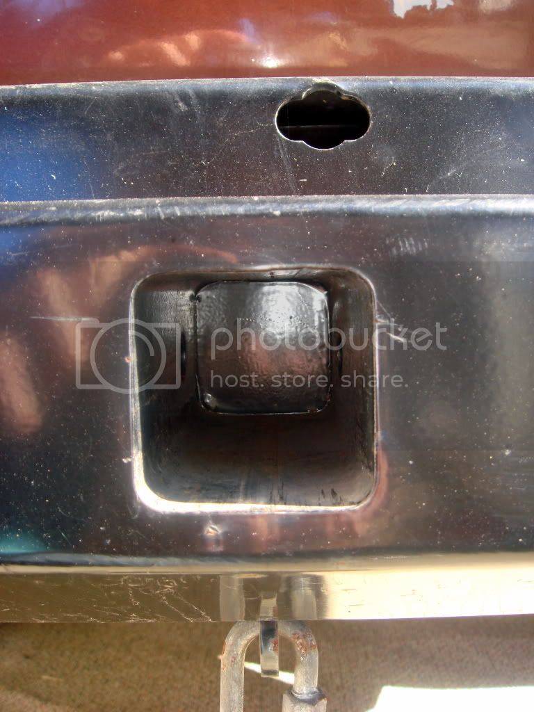

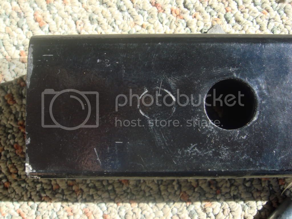

Ok, here are some pics. I think drilling a new hole might put it too close to the existing hole. I don't want the two holes getting together and deciding to make an oval.
The first pic is of the capped off rear hitch hole in the ARB bumper. The plate bolts to the factory x-member, so it's kind of needed there.
The second pic is of what's going on underneath. Note the hitch pin hole. I scribed the hole's location onto the hitch receiver.
The last pic is a detail of the hitch receiver, and where the scribed location is. This would be where the hole needs to be for the hitch to fit.
Cut the receiver hitch to use the existing hole? Other ideas?

I'd just cut the ball mount shorter to use the existing hole. Shortening the ball mount will reduce the leverage the trailer will have on the hitch which might be a better deal all the way around.
Redrilling the ball mount will work too. Since the bumper is capped there is no way the new hole can join with the old hole to make an oval.
