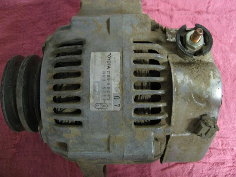

Not sure about the tech stream part, but if your alternator is a original Toyota one, if it's still in good condition, you might be able to get away with just replacing the brushes.
