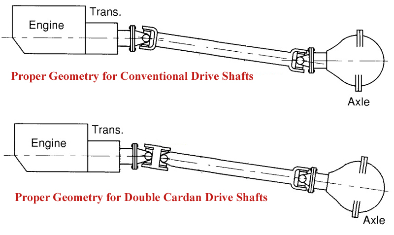

Should I do double cardan for back shaft?

The double cardan drive shaft question really depends on how you have your rear axle set up. Do you have your flange on your rear diff pointed straight at the transfer case? Or is the flat portion of it vertical and parallel to the output flange on the Tcase?
Double cardan needs the flange on the diff pointed straight up and at the t case. if thats how you have your axle set up then youll need to use that or youll get crazy vibrations.
If you have your rear axle set up like standard, you need to get it rotated to be as close to perfectly parallel with the output flange on the t case and you can run regular ujoints.

If you have adjustable upper and lower rear control arms you could run either.
Any benefit to the double cardan?
Supposedly they “flex more” but it’s mostly to get driveline vibrations under control. That’s why most shorted front driveshafts on Toyotas are DC. The caster adjustment will rotate the whole axle and push the pinion up anyways in the front
