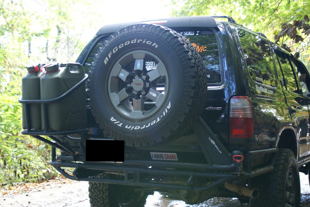

My company, Thetoyoutfitters.com, will make a swing out for any metal bumper. It holds the spare tire as well as a jerry can rack and can also accomodate a hi lift jack as well.
Here is one on our tube bumper for the FJ
Here is one on a 4RNR, the jerry can rack is the same for the FJ. The Hi-Lift mount goes on the inside of the swing out.

II probably told you that I needed either the bumpr or the truck and you just focused on the truck part. No worries :) I still get people that think I should be able to just send them a "kit"
