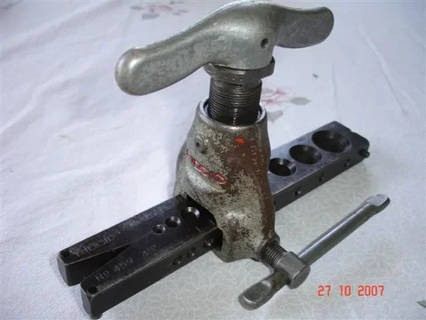

I'm a qualified refrigeration and air conditioning engineer/serviceperson and this is the "deluxe" flaring tool.
(There are many cheaper versions.)

I am not aware of a tool that will make the tubing have the step required for the o-ring to set on.
I have this, (and yes, it is all that and a sack of fries), but I do not think that it will make the step in the larger tubing required for AC lines....

Neither Poser - My forte is Commercial/Industrial (with a preference for "heavy refrigeration work" rather than "air conditioning" too). I've very little experience of automotive air conditioning and all my experience is now "dated" because I left the trade more than 20 years ago.
I really only replied because Scott used the word "vintage" (that's me) and I was confining my answer to "flaring tool" without any specific knowledge of the "O-ring assisted flare joint" he refers to.
The flare joints I used to make were almost always "copper tubing onto brass fittings".
