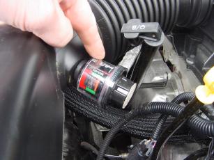

Get an air restriction gauge installed and do an experiment. The board is here for moral support. :D
