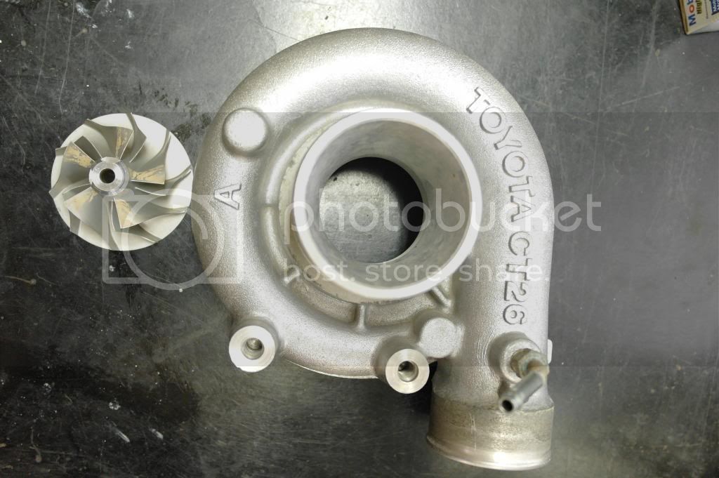

Does anyone know if it is possible to exchange the compressor and cover on a late CT20 'A' (90-93 2LTE) with the compressor and cover from any of the CT26's? I realized this would entail a full rebuild and balance.
I have a well tuned 2lte, and would like to improve my turbo efficiency a bit. Currently I'm running 15psi maximum (set by manual boost controller) through a water to air intercooler. I can hold 15psi to 4000rpm. This is about all the CT20 can do though, and I think I'm way out of it's efficiency range. I think it would benefit from a slightly larger compressor.
I was thinking of buying a used CT20, rebuilding it with the CT26 compressor side (perhaps from a 1hdt or 13b). I think this would increase my 40mm inducer to 43mm.
I happen to have a Supra CT26 compressor and cover which I've compared to my CT20 for fun. The Supra CT26 is a 47mm inducer, which is much too big for my needs (I think...). Anyone with a 1HDT want to trade compressor parts? :idea:

If you can get hold of the parts to build up a second turbo, it would be worth experimenting IMO. They share the same central housing, shaft and small parts (bearings, seals etc)

Interesting your supra wheel has the white paint on it, mine has the same but I thought it was the PO that painted it or something lol

Yeah, I was wondering about the paint on it too. I also thought it was from a previous owner. Weird.

Generally speaking extreme hybrids don't work very well. You end up with a turbine that produces too much shaft power at low airflow and drives a larger compressor wheel into surge. Then at the other end the small turbine can't provide the shaft power at higher flows that the larger compressor wheel needs.
The result is a turbo that surges down low, works okay for a very short rpm band and then chokes out the engine with excessive drive pressure and falling boost.
The only hybrids that generally work out are ones to allow larger or smaller A/R turbine housings than the factory options allowed or minor changes in turbine or compressor wheel size.
Hi Dougal, thanks for your experience. Although I have a picture of the 7mgte compressor, that is not what I'll be using. I plan to only upgrade my compressor slightly. So an extreme hybrid is not what I have in mind.
I suppose I should not bother, and instead put my efforts into looking for something like a used GT2056 that is more modern and efficient. And build an adapter. It's just that I like playing around with OEM toyota stuff is all.
