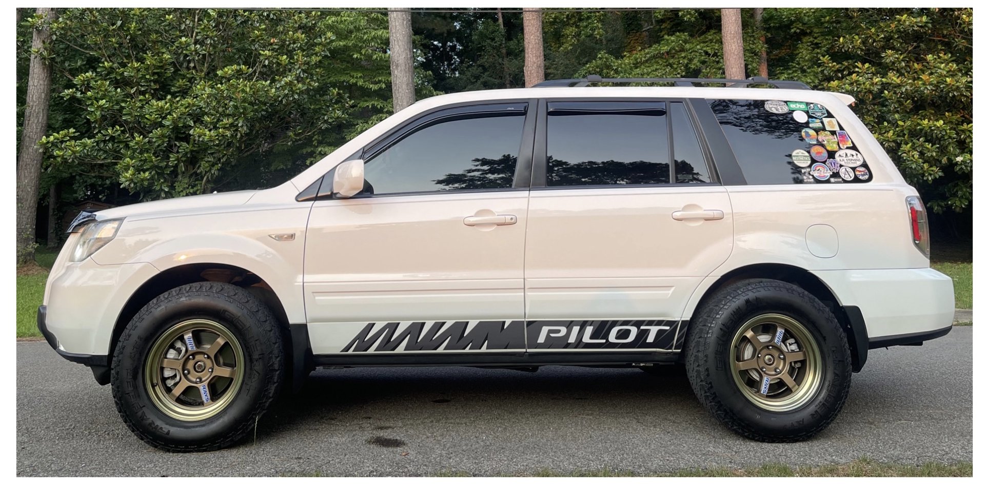

I'd start by getting rid of those wheels :)

Also….. I think your wheels are nice!
