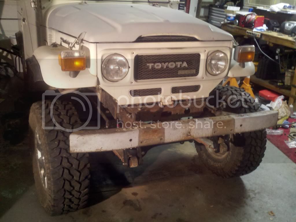

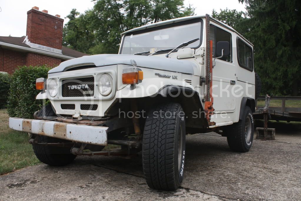

1982 BJ42 LX - lived it's life in Australia until 3 years ago when it was imported to the US. I bought her in Sept 2010.
From the factory she came with PS and AC.
As I found her.

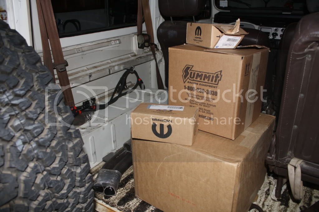

Then began the purchases...
Pre-cut and turned axle housing from Redline Land Cruisers
All Pro Offroad knuckle rebuild kit
Front and Rear ARB Air Lockers
ARB mini compressor
5.29 Gears
Longfields with cryo treated hub gears
Bilstein 5100 series shocks
Ford Shock Towers
Polyurethane bushings
Greaseable shackle pins
Ruffstuff shackles and ubolts
4x4 Labs High Steer
22 Gal Aux fuel tank to locate flush with rear cross member.

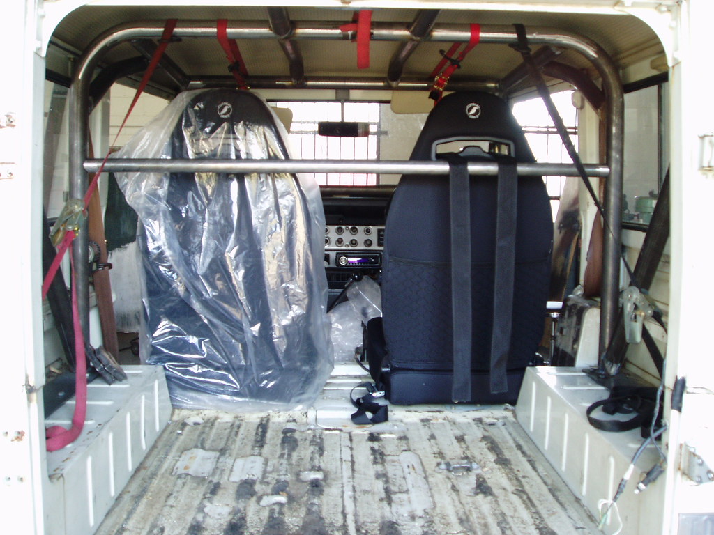

Metal Tech Full Cage
RCI Harnesses
JT Outfitters mirrors

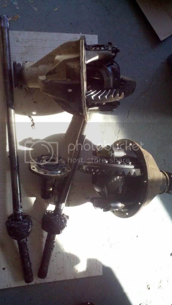

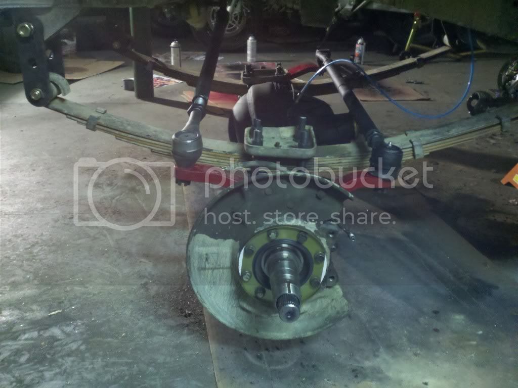

Out came the diffs and birfs
PJ did a great job with my lockers and 5.29s!

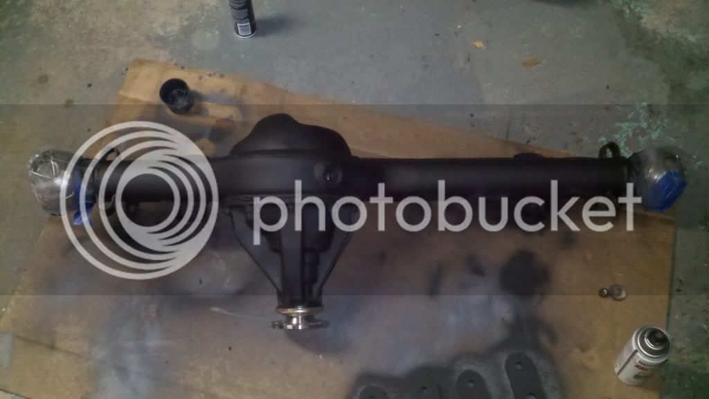

This is the prettiest this housing will ever look ;)
I think I'll gain a bit of suspension travel
As she sits today. Waiting on the bushings to come in.

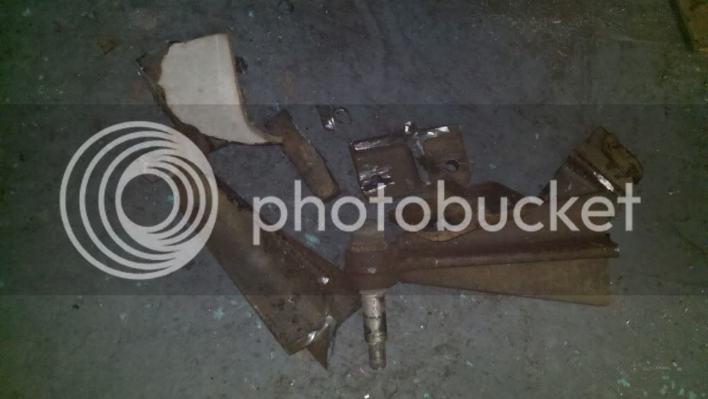

Screw you shock towers! Between the sawzall, drill, and grinder, those were fun to get off!

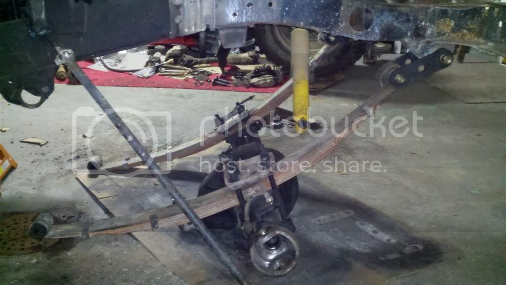

Front axle is almost back on. This next weekend, I'll hang the rear of the springs, begin mockup of the Ford shock towers, and start putting the knuckles back together.

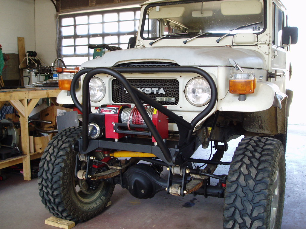

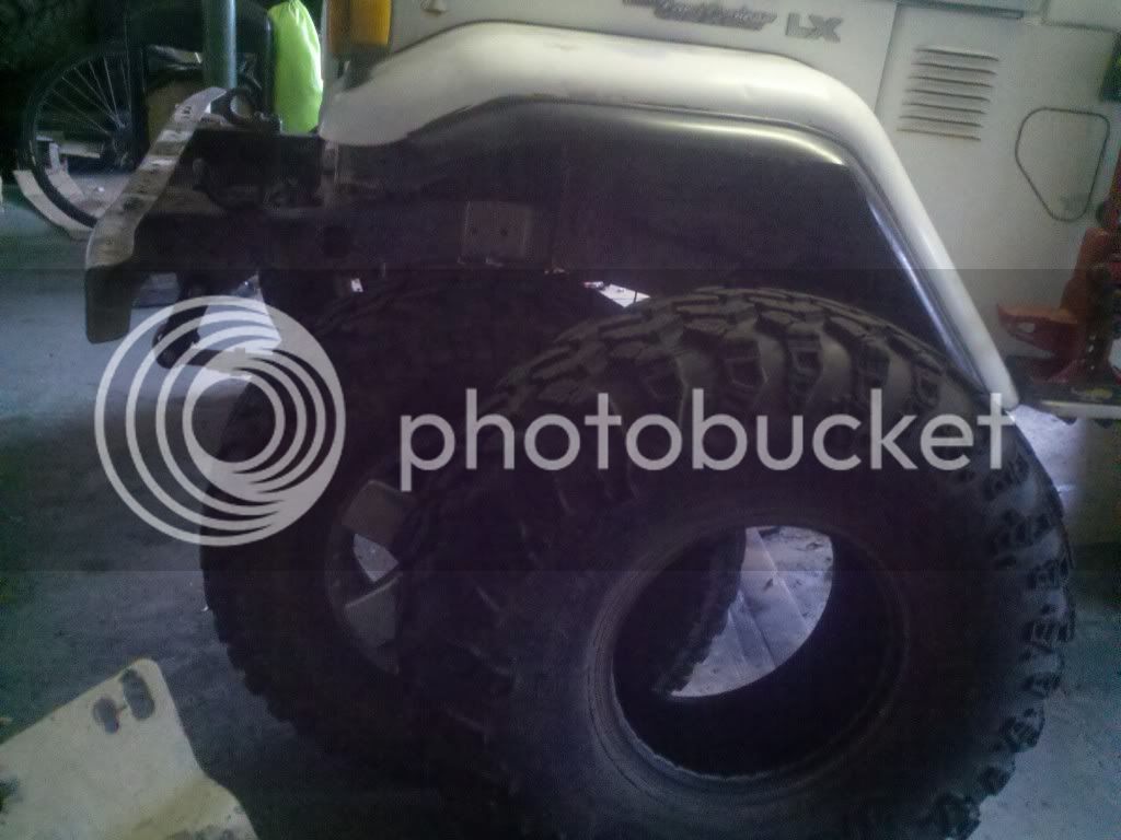

She's on 4 wheels again!
Shoes for when the rear spring over is complete 37x14 r15 IROKs!

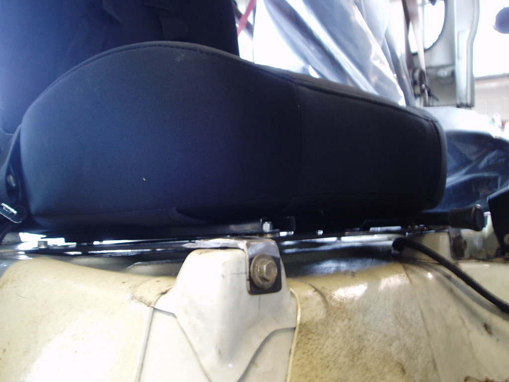

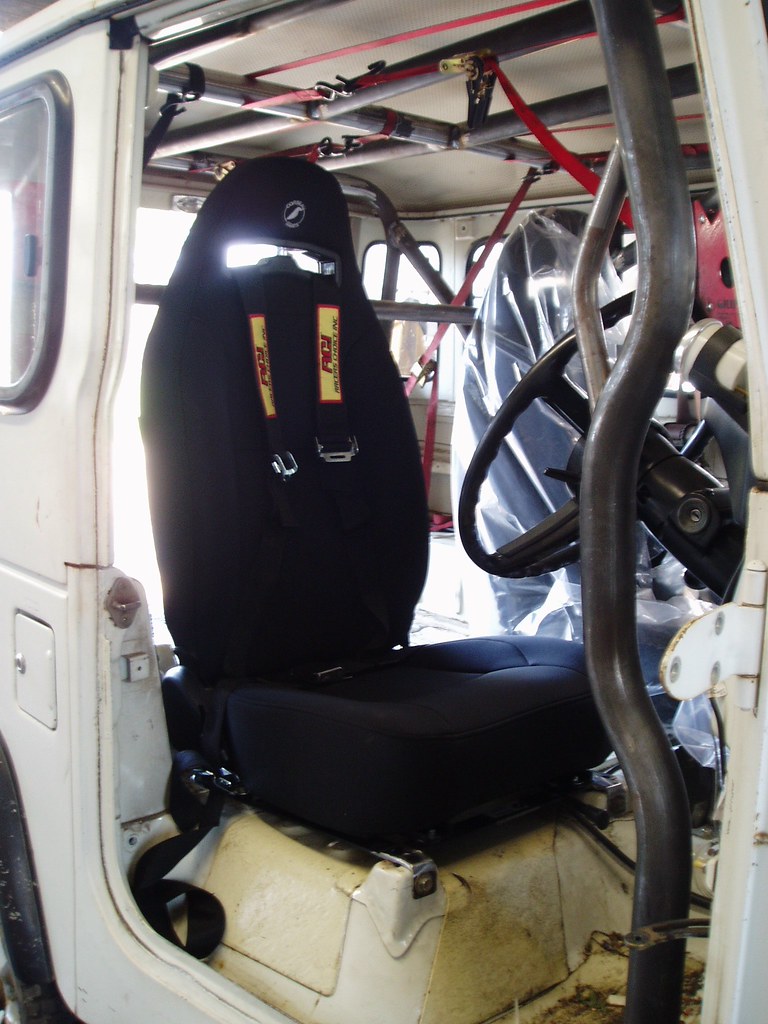

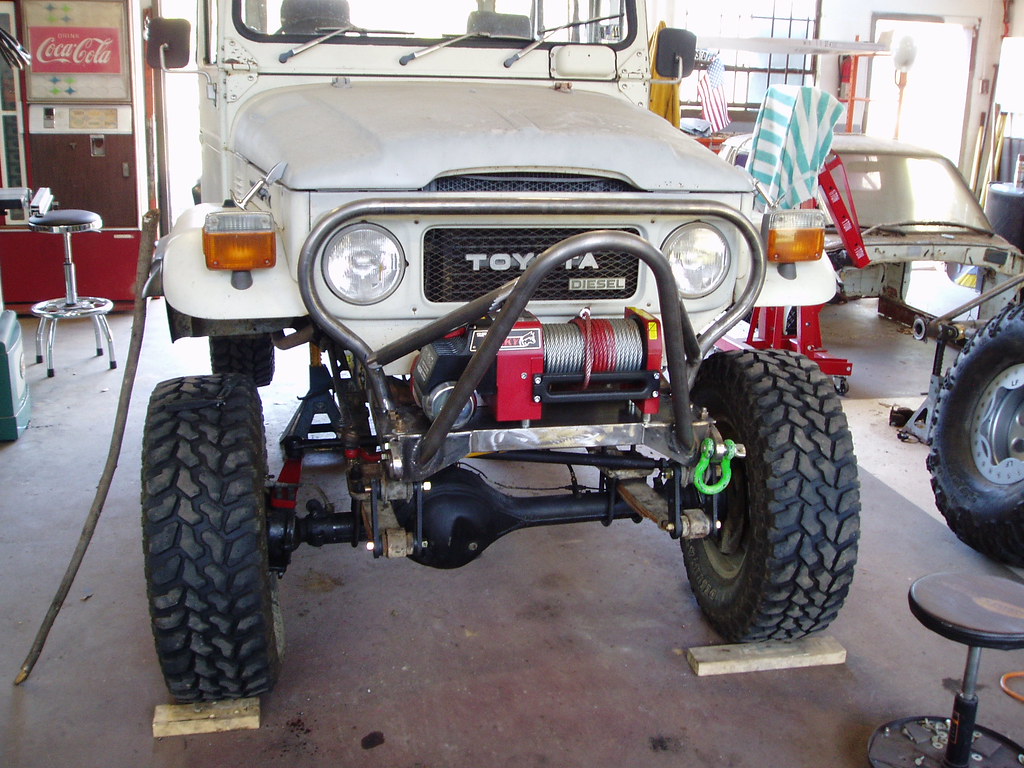

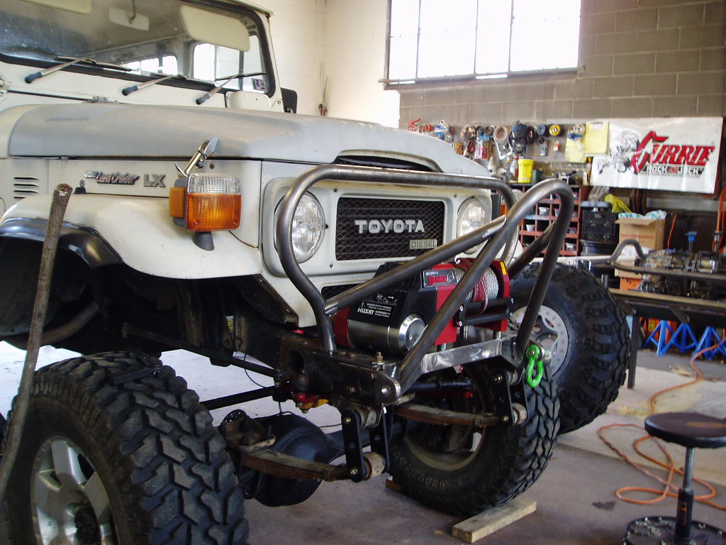

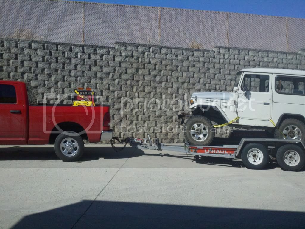

Hauled her down to SC this past weekend to have the custom bumpers and rock rails built. I'm also having the guy put in my MetalTech cage and create a seat bracket to link to the cage.
