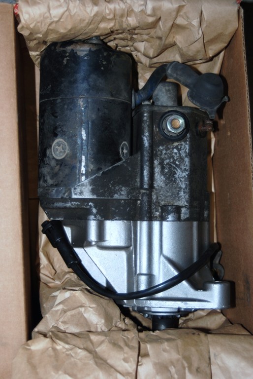

The nosecone is the part with the plunger/contacts (basically what you have pictured) so you'd need to fix yours to take advantage of the cheap rebuild.
The nosecone is the piece that mounts to the bellhousing. The rest is the body, which houses the contacts and motor assembly. I'll see if I can find a pic
so the bright new shiny part is the piece that comes with the 2l starter. you swap that off the new one and put yours on so it fit's the 3b. The pic is my old starter motor and contact housing on the 2l nose cone. make sense? Supposedly you can do the same thing with cummins starters. There is info here from lowenbrau.

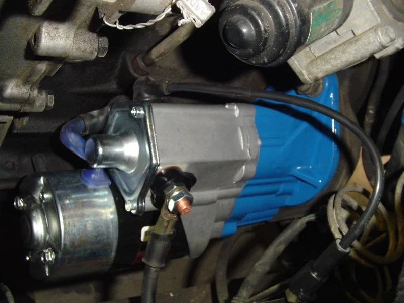

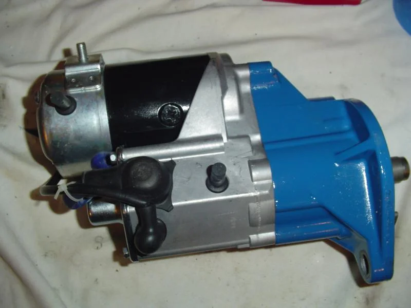

My starter is in and running smooth. Thanks to Cruisre Guy (thanks for ur patients), Wesintl (couldn't have done it without u) and Lowenbrau cuz he helped u out.Had to bling the nosecone, hope u like. :cheers:

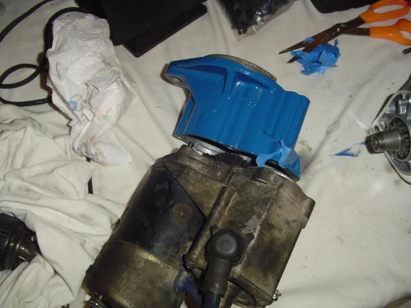

I ended up buying a remanufactured starter from my local Toyota dealer. I traded the nosecone and installed it myself, about one:wrench:. I couldn't be happier with the unit.:) I put the new nosecone on the old starter and took it back for the core deposit. Hope this helps. :cheers:
the 12 v from toyota 28100-54090-84 which is a 2.5 kw gear reduction. then swap the nose cone. It was like $120 from toyota. I'll sell you my almost new contacts from my old one if you want.
Thank you! Did this last night. I could not have been easier! Pulled the 3 bolts off of the working end and 2 on the back end (don't remove the 2, just back them out and leave them in place and the cone comes right off.
