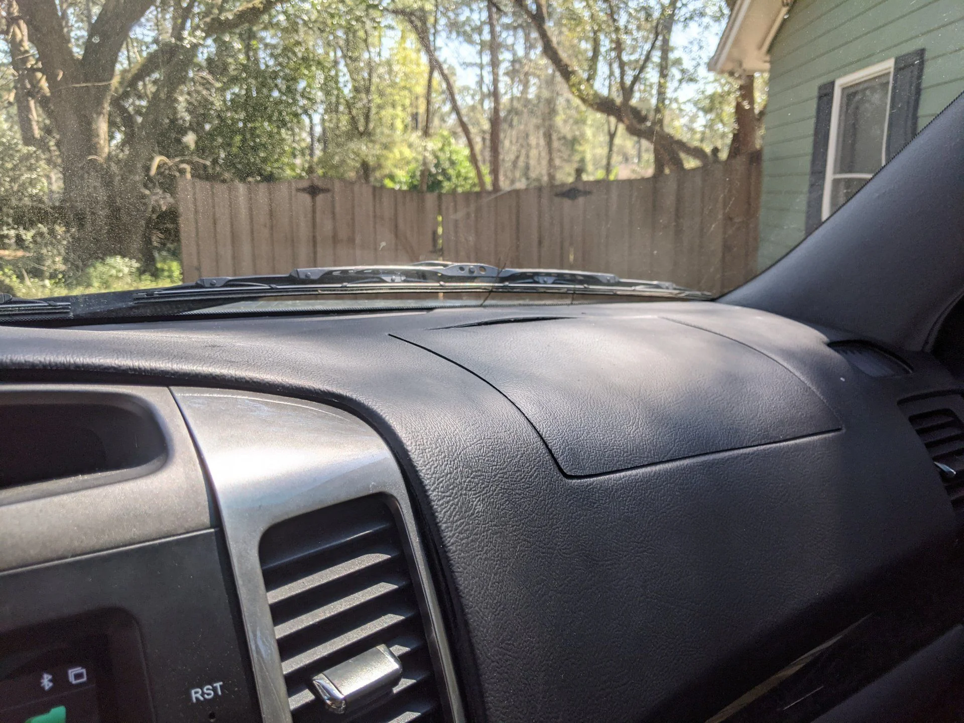

I have the Coverlay. It's hard plastic compared to the softer feel of oem. Also it curled at air bag so the air bag piece and the main dash piece don't line up.
Coverlay replaced it and then it did the same thing again.
You have to lightly sand the air bag cover piece so it sits flush on the opening of the cover.
Also you need something to apply downward force on the Coverlay when first applied. Think like heavy bean bags and cardboard to wedge between windshield and dash.
It def looks better than a dried up lake bed oem dash but imo it isn't the gold medal of options.

Thanks for the picture and review. I found another review on YouTube that was also not impressed with the fit and finish on the Coverlay. The cheapest I've seen the Coverlay is $412 shipped on Rock Auto. At that price it's not far from the price of an OEM dashboard (~$600 at some dealers).

Thanks for the review! @NorFla Nomad I saw Cructhfield Clan on youtube install a coverlay dash onto a GX recently, and quite frankly wasn't hugely impressed. I think I'll probably save up, pick up an OEM dash, and do the work at some point. 🤷‍♂️
