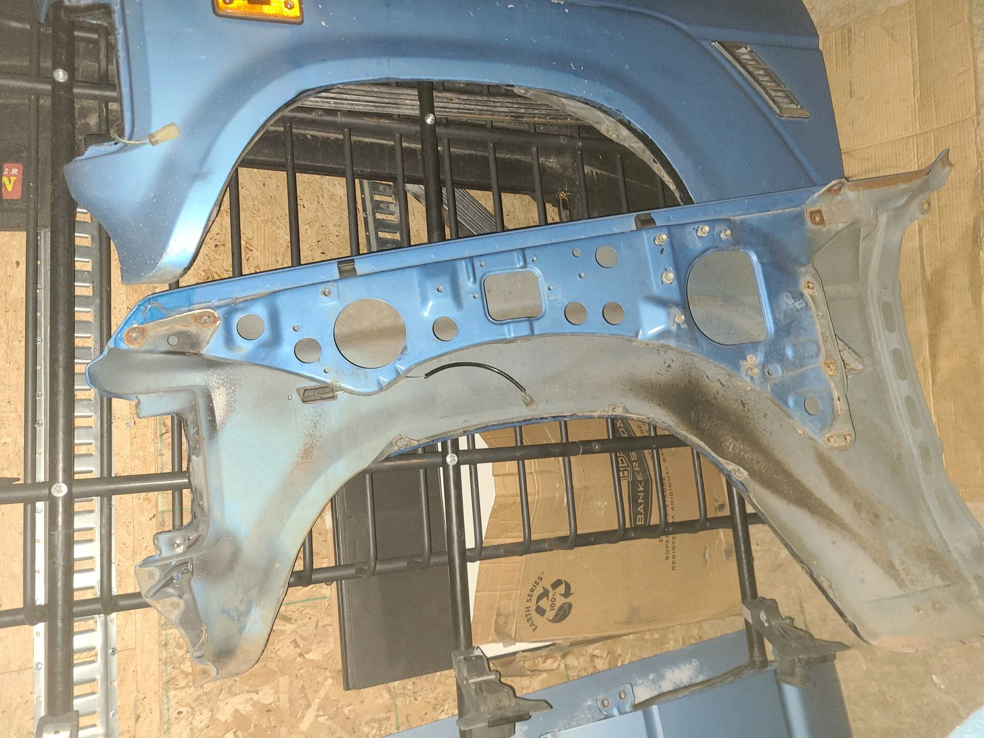

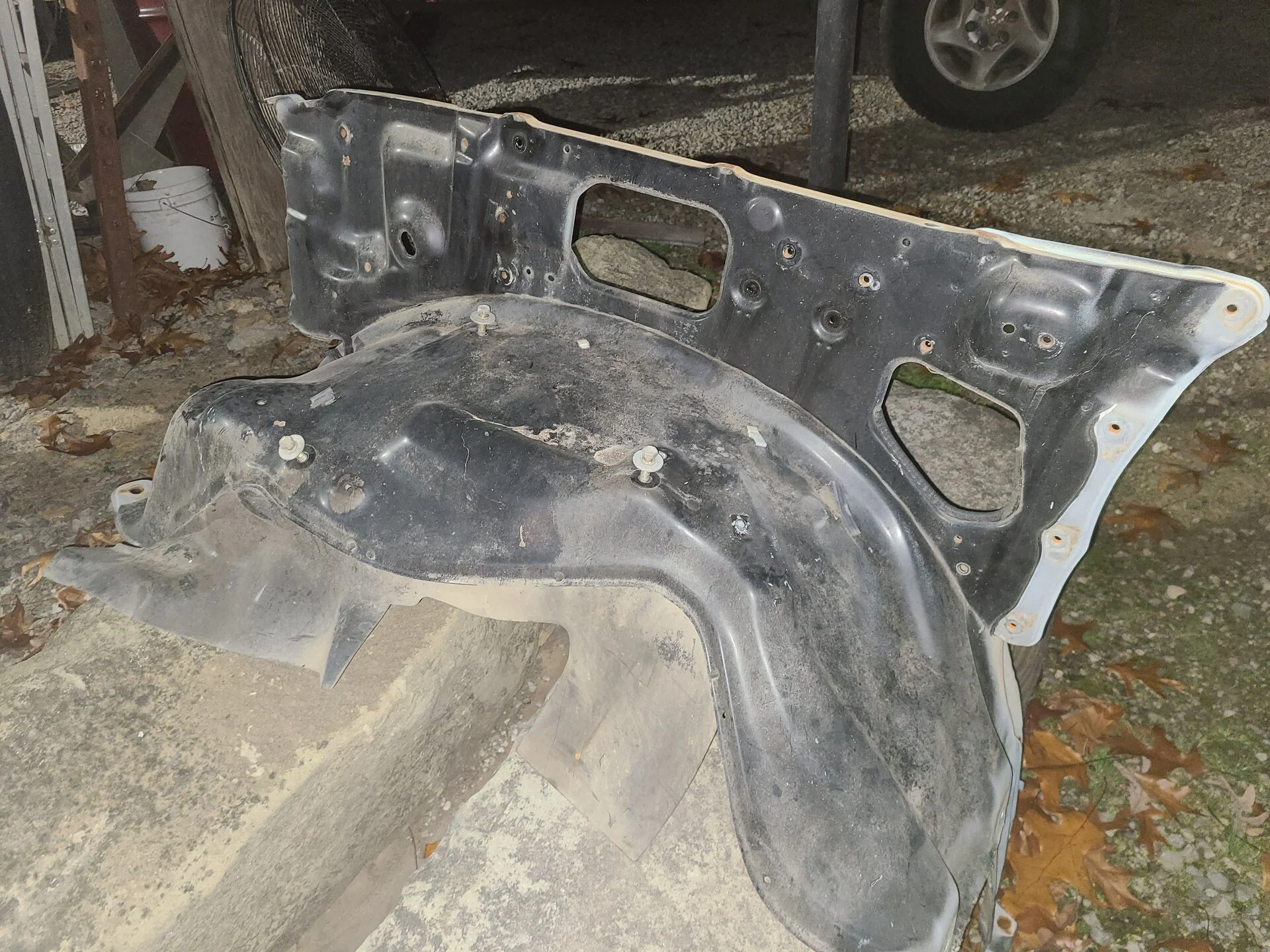

2nd question regards the front clip. Inner fender wells specifically. How did you handle it? The original FJ60 inner fenders are just basic, but they dont fit around the 80 suspension without modification. And the FJ80 inner fenders fit around the suspension nicely, but they dont play well with the FJ60 fenders.
FJ60 Fender has the vertical section on the fender itself.
And the FJ80 has that section on the inner fender. And it also had the appropriate mounts for the air cleaner I plan on using.
But I'm not quite sure how I'm gonna splice them together and could use some previous examples.
A:
I would suggest going to the 60 series section to see what other owners have done. You're going to have to modify to whatever your needs are. How to mount the intake filter canister or whatever engine you're doing. If it was me, I'd use the 60 inner fender well and modify the sheet metal where needed to clear structural parts and fill in where necessary. This is what I did when I did something similar on a Chevy 40 years ago. I modified the cab mounts on the frame (without welding on the actual frame) to meet the new body. Then sheet metal got carved out and filled where necessary. Get additional rubber sheets to do fender fill-in to the frame like "lift lips" to fill the visual gap between the frame and sheet metal. Just make sure to adapt the 80 series master cylinder, steering column rag joint, and throttle pedal to the 60 series so your mechanical components work the same.
