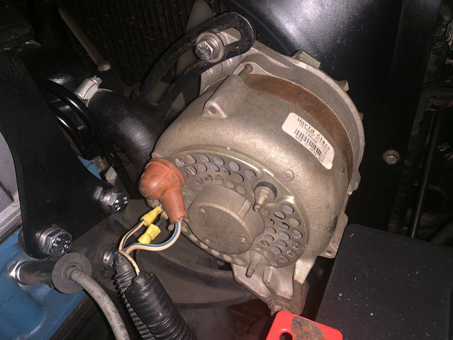

See pics below. I bought this guy from an advanced auto 15 years ago. Let me know what you think on this
That appears to indeed be a NipponDenso TOYOTA Alternator , its a Straight
Tab style ..........
you can take the WORLD CLASS part # 14540 and run it online to see whats
what with all that .............
it is very common place for aftermarket 3rd party re-builders to install wrong
pulleys , or sell a Angled TAB instead of a straight tab as u have there ......
one last observation , and moderate
RED FLAG , your 2 smaller wires that
enter the unit below the large white one with a blue tracer stripe ,
are not secured with a factory Electrical Connector like the one i will show below ,
you should address this very sooner rather then later .............fyi

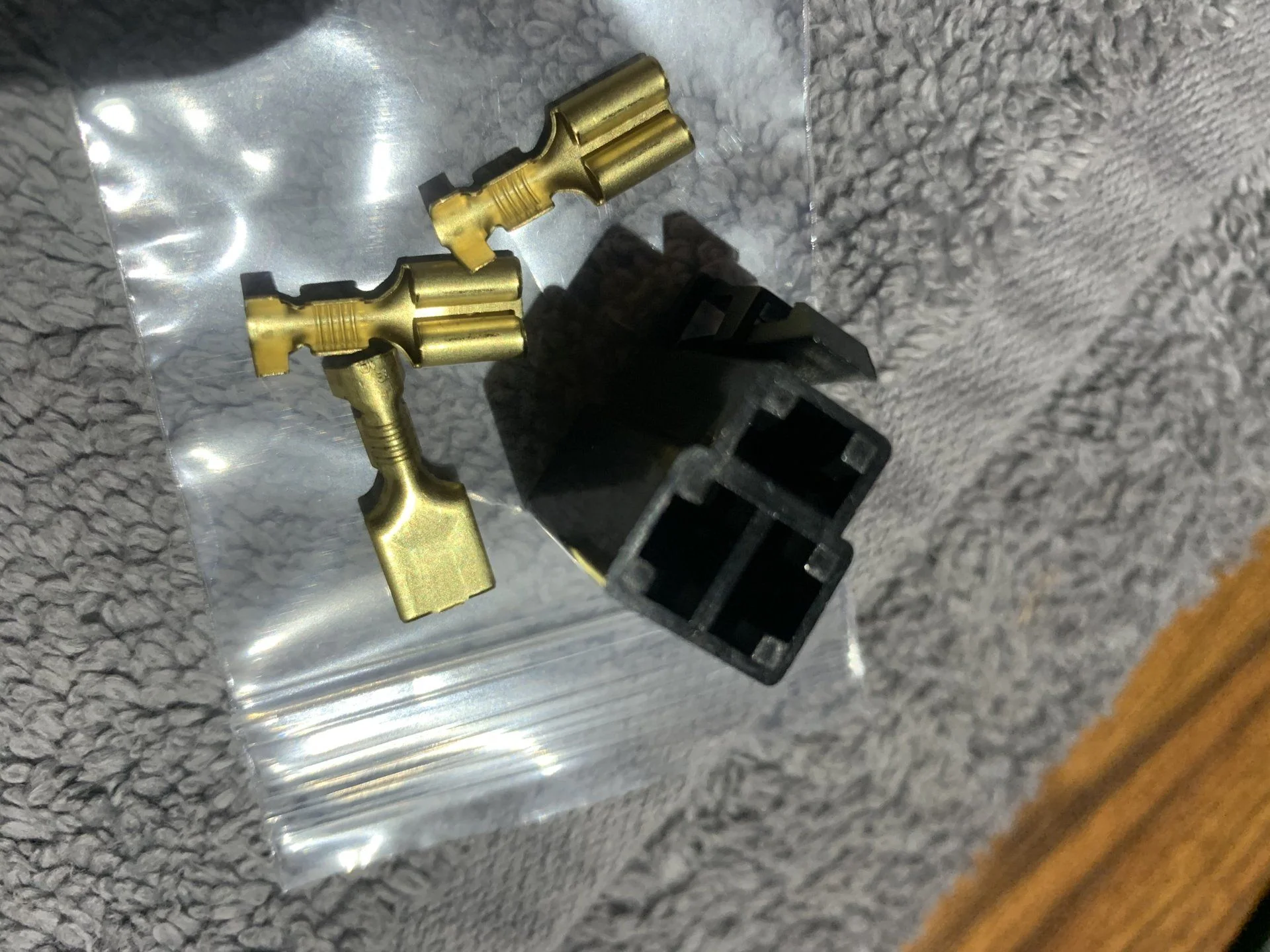

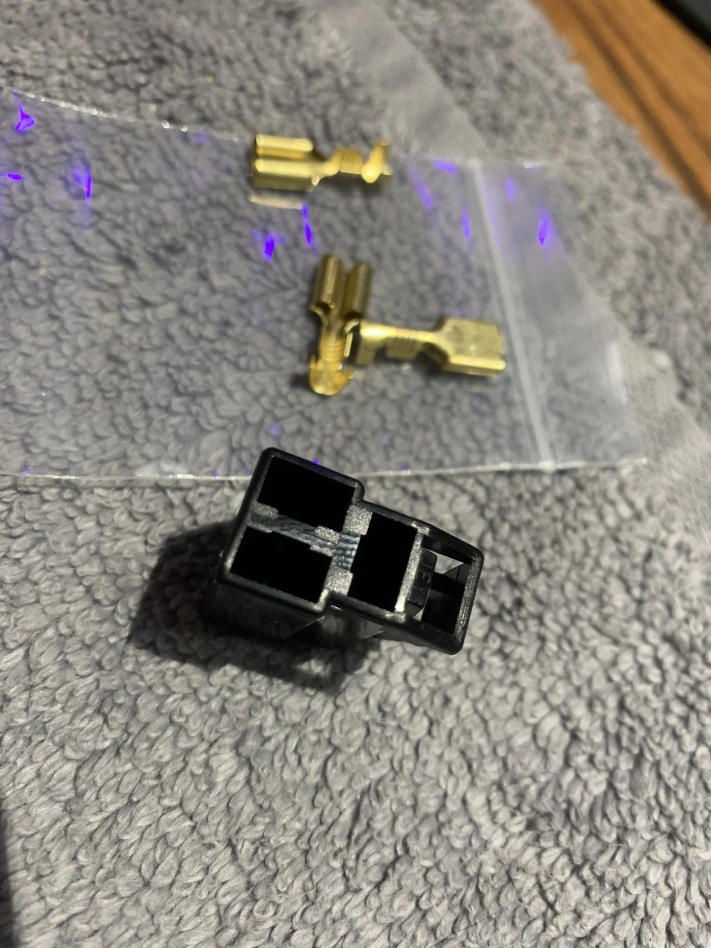

Here is a OEM Toyota PArts Maker Yazaki brand
UV rated Alternator 3 pin profile connector and 3
Solid thick brass terminals you will need to do
The correction repair

I am not worried about the electrical, it’s the pulley I need dialed in. Will the factory pulley fit this alternator? I also need the JT outfitters PS pulley replaced with one I can run a 17mm belt on
YES , my pulley OEM Pulley will correctly fit this unit ,
if we are still unsure ?
pop it off and measure the ID of the pulley center hole .........
Awesome. I will dm you and get your phone number and we can chat about the pulleys I need for alternator and PS pump.
