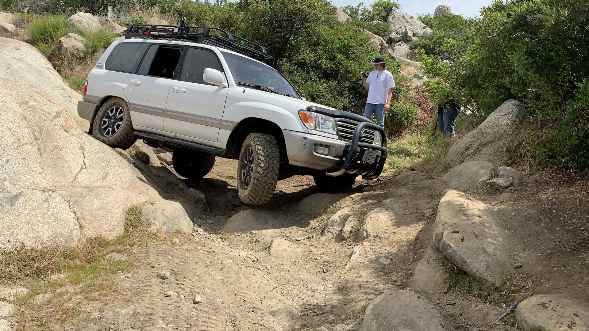

A few shots from Saturday. All these were pre carnage. This trail really has Mike’s number. Mike now has a matching dent to match mine frome my last misadventure 2 weeks ago.
That trail does have my number! And NO, I'm not going back to conquer it! The rock that got me was the same one as last time.
So, here's what happened. I knew it was going to be tight. Not wanting to deepen my wound from last time, I went in slow. TOO SLOW. If I would have tried carrying just a little more speed (like 1mph more), I would have got my front wheels up to pull me through (yes, only the front locker). Instead, by going in slow, I broke traction with the right rear and left front. That pitched me into a little slide to the right side where the big toothed rock lives. In a panic, I turned the wheels hard left. CV's, Locker, hard turn equates to loud noises and parts flying out from under the truck! It all happened so fast! BOOM..BOOM with a split second between them. Parts literally flew out.
Now I'm not only stuck...but there's only about 1/4" between the truck and the rock. I could feel the rock stretching out trying to grab me. I was trapped inside the truck. I couldn't open the door to get out. I sat there watching everyone scramble to come up with a plan to get me out. As soon as the winch went tight, the back slid over and made contact. The rock was happy...I could feel it! The more we pulled, the worse it got. The rock even put some nicks in the window trim but the glass was spared. Brian, Michael and his friend Hayden were sitting on the rock and pushing with their feet against the roof rack (the rack came in handy). One winch pulling from the left slider to the side and another from the front got me up to where I had some 2 wheel traction. Once out of the squeeze, a small tug got me to the top. I was able to get out from there.

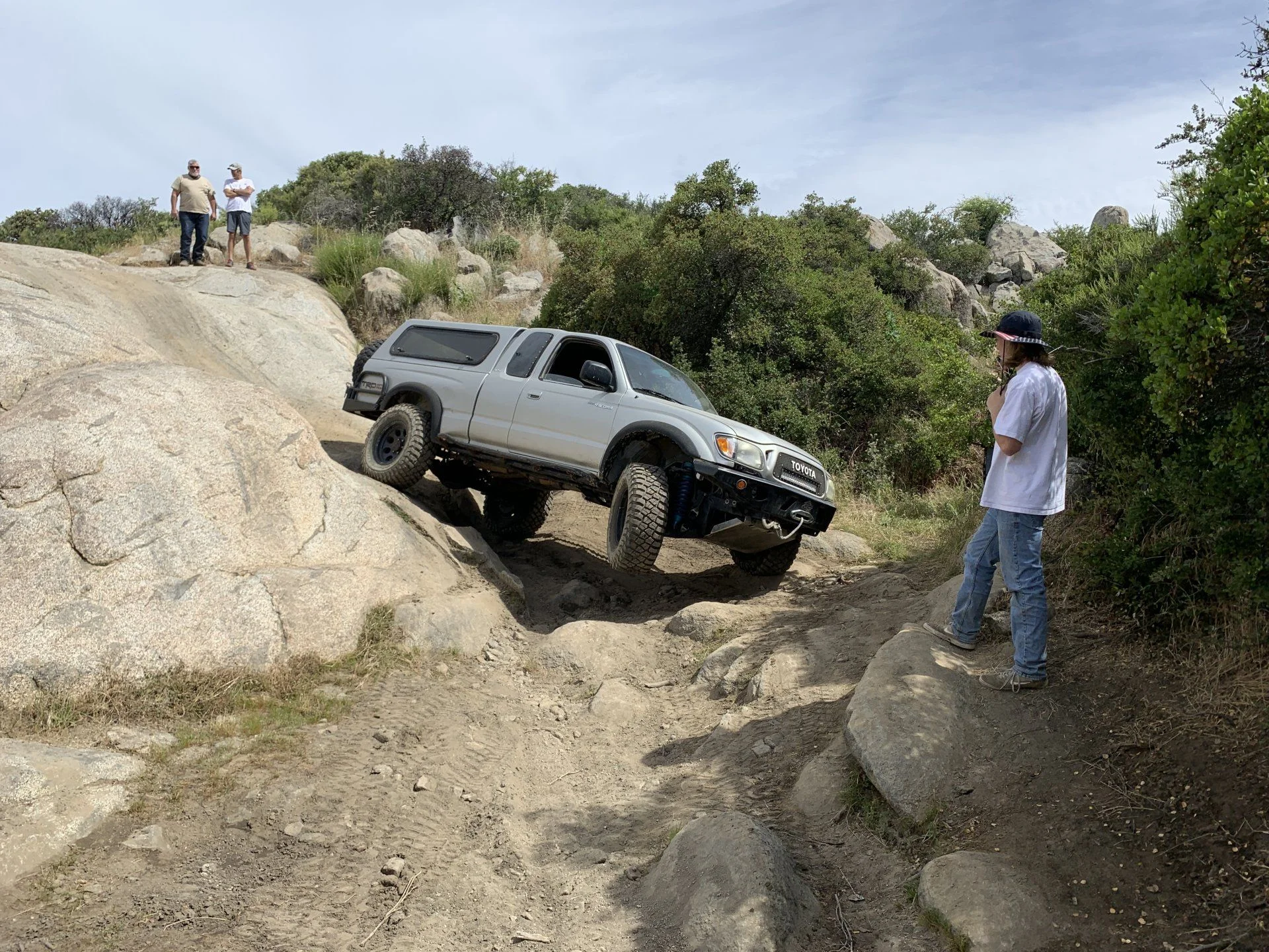

Man that is tough, feel bad for you brotha! Good idea though, if you want to wheel those types of trails an 80/60/40 is a good idea. That said... Nick's IFS Taco made it through no problem?
Well that's one I knew of....
