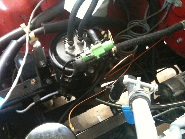

I went with the copper line just for that reason. Blew out a plastic line on a Volvo I had one time. Never use plastic again.
How's the copper hold up vibration wise? Did you put a flex loop like the brake lines have?
Tony
I think it will be ok. They have been plumbing gauges with copper line for awhile so I feel better with the copper. I did leave a loop in it because the line was 6ft long and I didn't want to cut it. Here's a pic:
