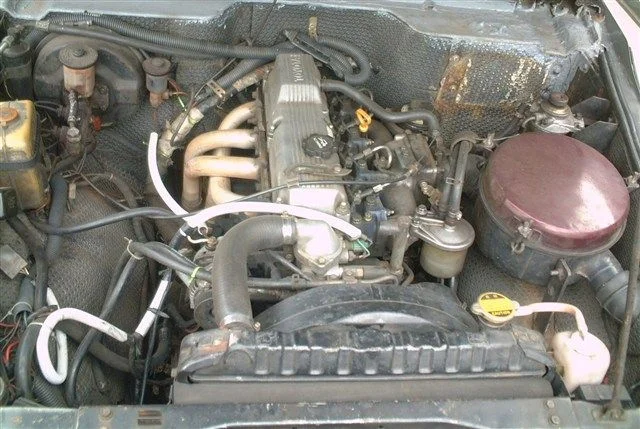

I forgot I had this pic of a 14B in a 55 series which is the same as a 40/45 as far as engine swaps go. It was Indonesian ex military vehilcle

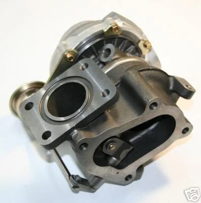

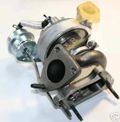

A couple of pictures from the Ebay auctions. The turbo with the 4 hole exhaust housing flange is the FTE while the other is the FT
The turbo listed for the FT is the CT12B.
Possibly the same turbo used on the 1KZ-TE's which are quite common over here.
*edit*
Looks like they went to IHI turbos later on (4 bolt shown by snailtrail). Still looking.
