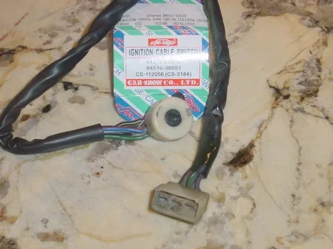

I got a reproduction switch new from Cool Cruisers for around 20 bucks. Works fine. As stated above, you can change out the switch without having to re- key it. Very simple job, remove the phillips screw, unplug the switch under the dash. One quick edit, the switch should be in ACC. position when you remove it. (thats what the book says so I'd go with that)

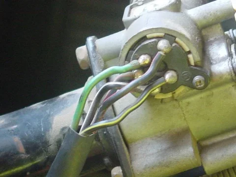

Piece of cake. Remove screw. Pull the switch off, disconnect the connector.
These are pics for a BJ (diesel) with a glow position so there is one extra wire on these but the principle is the same for a FJ.

Thank you Mud members for this. It just killed a long running electrical gremlin. For me it was intermittent over the last year or so (power would cut out suddenly once every couple of weeks typically when I would hit a bump in the road). Last week it just gave up the ghost almost completely. Upon inspection, the solder on one of the wires was broken and the small inner copper plate within the switch was very worn out. 10 minute fix to replace. No more worries of losing power in Chicago traffic. Love it!
