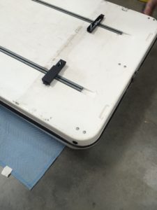

Looking for some help. I have a columbus RTT and the eeziawn k9 roof rack. It looks like the mounting rails for the tent line up over two of the slats of the k9. My arb rtt was spaced enough to be between the slats so that i could screw it on with the k9 mounting kit. Does anyone have this combination? If so what did you do? i do not want to drill through my rack unless absolutely necessary.

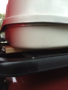

well s*** forgot about this thread. got both the front runner and eezi awn mounts. while the eeziawn mounts where thicker metal, the FR lined up better, had to lenghten the mount hold a skotch. ill get some pics of it mounted.
I ended up scheduling the install of the roof rack and our Maggiolina at equipt to do the install and we ended up buying the equipt tent mounts like yourself and Paul inverted the mounting brackets for the install because they wouldn't line up with the k9 bars. Then we had to throw some 1x4s under the tent to stop it from flexing and banging around. Not an exact fix but it did the job for the trip we just got back from.
