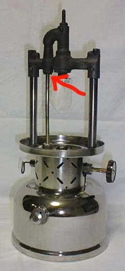

It can be taken down further than that. Was the fuel coming out of where the arrow is pointing?
Cool. Not sure........I didn't make it home in time to play with it. Hopefully tonight. I'll post up later. Thanks for the advice!
