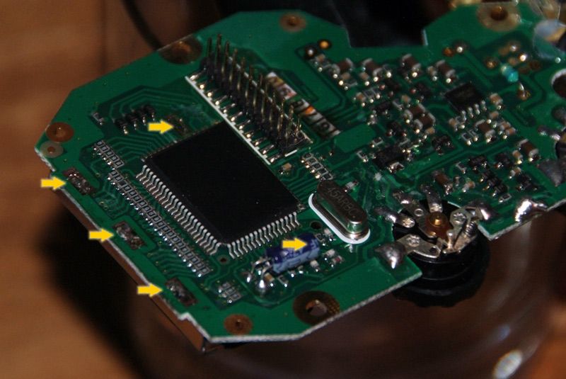

Most, if not all, will leave the display color well enough alone on their Cobra 75WXST CB radios. The factory dash colors for an 80 are green and so is the display on the Cobra. Should you decide to, here is a fun project that kept me occupied for a bit.
Step 1 - Take your new 75WXST out of the box
Step 2 - Take it apart ;)
Step 3 - De-solder the LCD from the circuit board. In pic 1 above you can see the five attachment points marked with a yellow arrow.
Step 4 - Under the LCD you will find two SMD LEDs pointed at each other. The board is marked positive and negative but make note of the LED orientation.
Step 5 - De-solder the LEDs. I use a solder sucker and zero force to remove them. Once all the solder is gone, they will fall off on their own.
Step 6 - Take the new LEDs out of the packaging, sneeze, and spend about an hour looking for them on the floor. On a serious note, make sure to ground yourself as static electricity will destroy the LEDs.
Step 7 - Solder the LEDs to the board. I used a small pair of tweezers to hold the LED and backed each leg into a solder ball added to the board one leg at a time. Polarity is marked with a green arrow on the back of the LED.
Step 8 - Reattach the LCD. It is important to secure the LCD as close to the circuit board as possible. Use a pair of needle nose pliers to squeeze the two together as you solder the LCD back on.
Step 9 - Reassemble.
Step 10 Optional - Squeal in joy that the thing still works when you turn it on. :D

reviving a really old thread to say thanks to the OP for the walkthrough!
i swapped mine last night in an attempt to match the amber option on my Kenwood ham radio. i used part # APG1608SEKC/T which came out a little too orange, probably should have went with APG1608SYKC/T - but still better than the green. i got 4 of them (2 extra in case i sneezed!) from Digikey for just over $5 including shipping.
they are also a little on the bright side. i had some tinted vinyl on hand so i covered the display with that to tone it down a notch.
