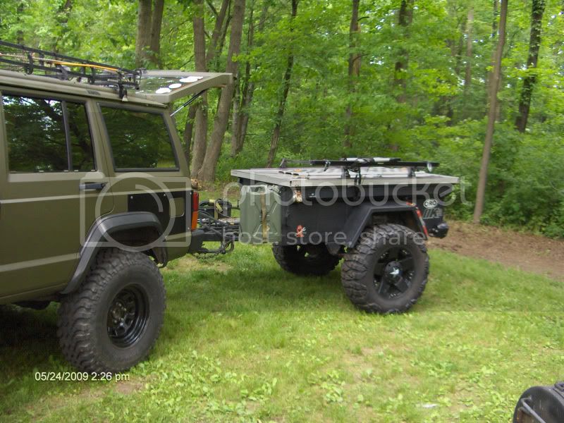

as for the rest of you guys.. i am blown away with your comments.. i posted here to thank you guys for the ideas i picked up here and did not expect the responses you have posted .. i have just returned from the maiden voyage and was very pleased with the trailer.. it pulled great i did not know it was there.. and i dont think my gas mileage was affected at all ( none that i could notice ) any way there are a few little things now to add proper latches propane and jerry can mounts and most important the roof top tent .. just gotta find one ..
NICE WORK!!!! Can you give us a couple more pics of how you did the tailgate?? What did you make your lid out of...Steel or aluminum? It looks great

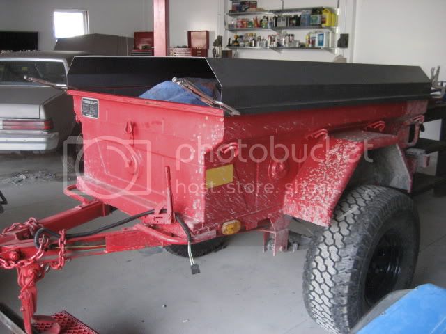

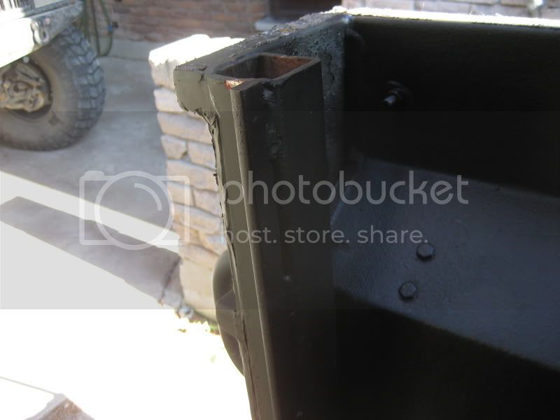

sorry for the delay been soooo busy..anyway ignore the paint job i had 2 nights to make look decent enough to use for the weekend i hope these pics help. hope to fix up the paint job real soon..

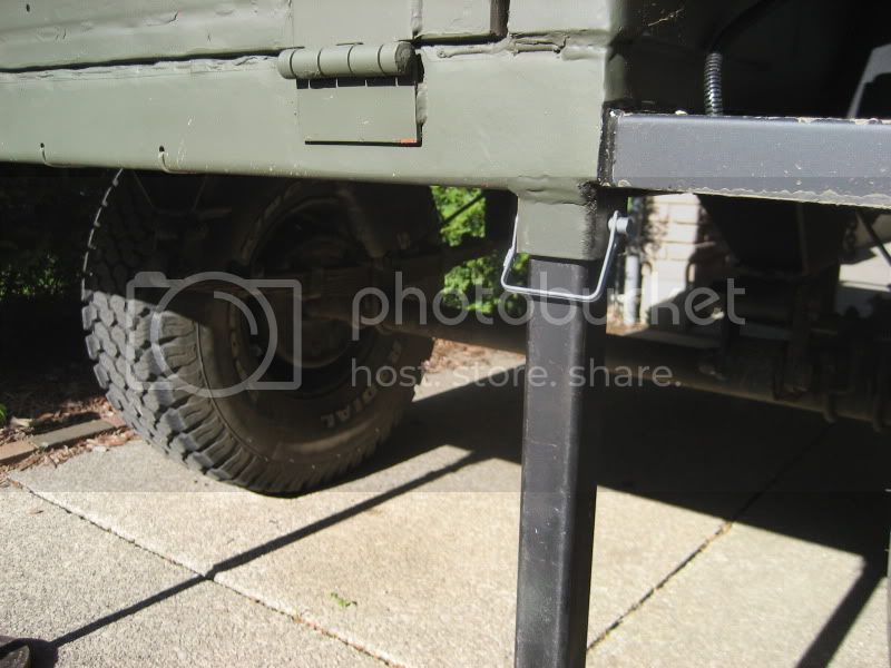

so we welded in some 2'' sq tube cut throught the floor and out the bottom welded to the frame as well .. used the the tube as a guide to plasma cut the door out inside the 2'' is a 1 1/2'' sq tube with holes drilled for the pins . a nut weled on the end for some acme thereaded rod and a round plate to that for a foot pad. i think i will add a couple of wings to the feet to help screw em in and out .. i looked at hydraulic screw type trailer legs but this was simple and free.. i like simple and i like free even better

I'm going to steal that landing leg design.

steal away .. i thought it was simple but effective.. as far as the od xj i watched your build up on the other site with intrest cuz i did mine a couple of months before you .. you did a nicer job though ..

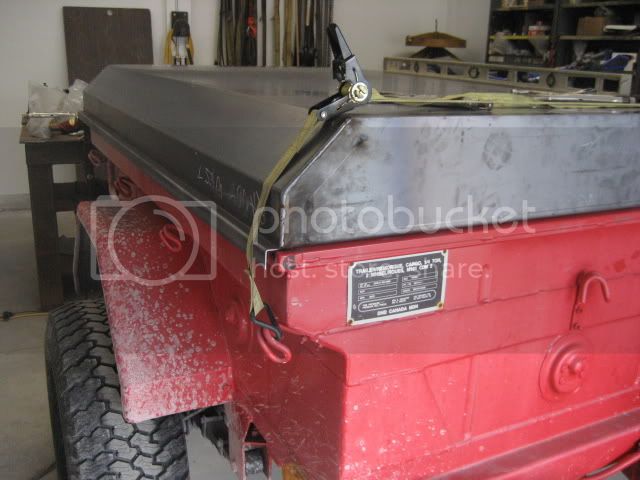

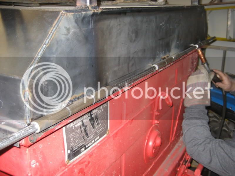

lid pics ........shudda took more, hope these help,
one piece bent to shape, ends weled on, one support underneath 1'' square tube plenty strong , racks welded to the ends and the support bar..
