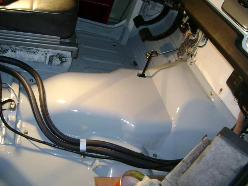

Finished the clutch job, seems to work very well much quieter with the new Pilot and Throwout bearings. Drove it for a short while with the hump off to see if any problems reared their ugly heads.
Closed things up. New heater hoses and some plastic wire loom found in the bargin bin at Summit. Used rattle can, the paint on the hump came out nice. On the floor I used Rust Bullet, Rustoleum primer and then paint. The floor did not come out as nice since it was very rusted & pitted, but I hope the rusting issue is put to bed for a while and I'd like to cover the whole thing with carpet anyway.
Heater rebuild coming soon.
