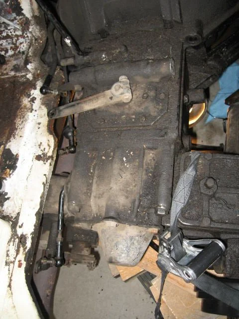

Started on the clutch, just don't know how to get the tranny away from the bell housing?
As I recall, it was just STABBED in.
You got all the bolts dc'd, right?
NICE JOB!
It was just stabbed into the motor, right?
That was how mine came out as well when I did it.

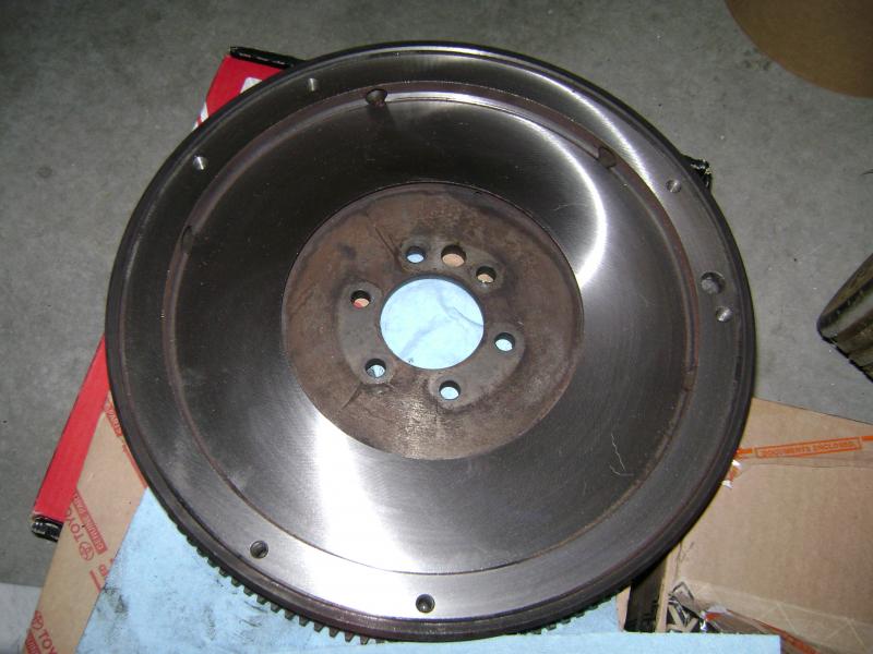

Bayshore Trucking. I have had two of my flywheels turned there. Good guys and they do great work.

When going back together, just make sure you have the alignment tool, put it all together, tighten everything down, slide the tranny back into place. Pretty much goes back together the same way you took it apart. The only difference is "aligning" the clutch disc in the pressure plate, so that the tranny will slide back into place.

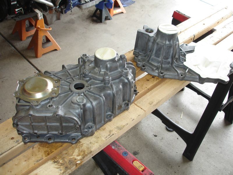

Tried Bayshore, but their machine was Ka-Put and they referred me to Reno Clutch who did a nice job on the flywheel. Amazing how much time it is taking to clean the 40 years of **** off of the tranny/transfer case.

Next time try EZoff, oven cleaner works wonders on T-cases an knuckles.

It didn't touch the paint on my transmission.:confused:

for future reference i think if you purchase your clutch assembly from reno clutch they will surface your fly wheel free, it has been a couple of years sense i used them but that is what they did for me it was part of there warranty
