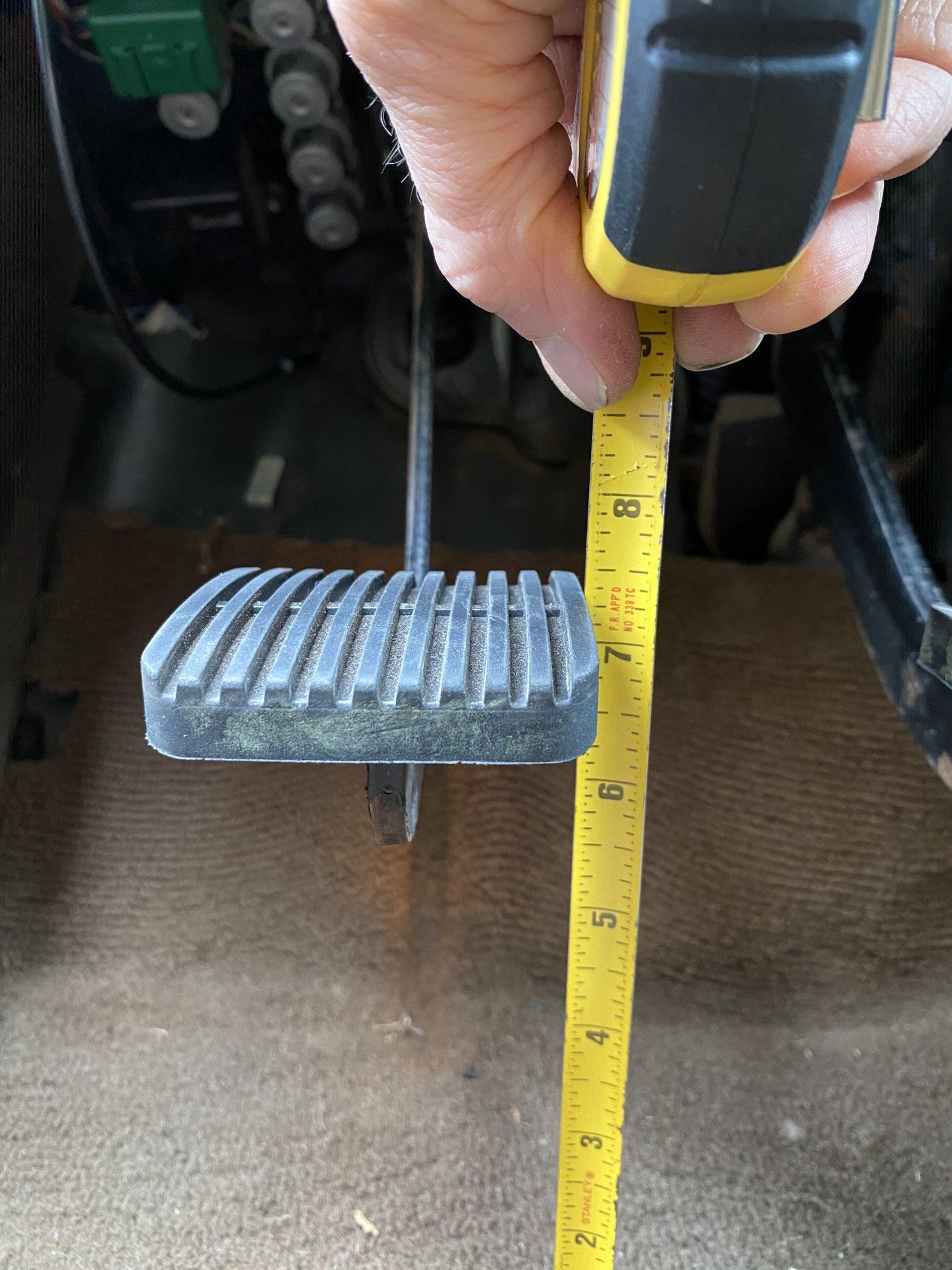

The diagrams above are very helpful. It feels like I’m pushing my clutch through the floor when I try to get into reverse or 1st so I thought I could adjust the push rod. my pedal height is correct but I have almost 2 inches of play before I feel pressure on the clutch. When I look at the adjustment screw it’s already backed out as far as it can go so no further adjustment is possible.
