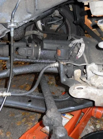

    I'm in the same boat. Started on my front axle service and found this.
    The front pinion seal is bad and has thrown grease from one side of the truck to the other. You should see the knuckles! I picked up a hot water garden hose and some Simple Green. I'll run the hose from the laundry room and I hope the heat and degreaser will do the trick. It's a good thing I was able to participate in the Just Differentials gear deal. :grinpimp:
    This also brings up an enviro-ethical question. Since I'm doing this in my driveway the runoff will go to the storm drain. Anyway to minimize the oil/grease/cleaner in the runoff?

    Geez that looks like you bed-lined your front undercarriage :lol:
