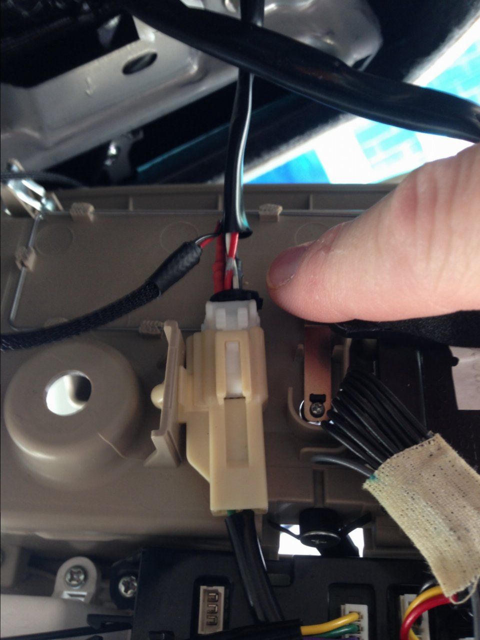

5. I selected to connect the Mirror Tap to the back side of the modular plug on the wiring harness for the overhead console lights. I selected this plug for 3 reasons. 1- It was a two wire plug that had a power and a ground. 2- If for one reason I blew a fuse or caused some kind of damage it was only to my map lights and I could live without them for a while. 3- This power source comes on as soon as I unlock my Land Cruiser with the remote key and it goes off either when I lock the doors upon exit or after a few minutes if I don't lock the door with the remote key.
6. Put the key in the ignition and plug your Mirror Tap wire into you radar detector. If it works zip tie the Mirror Tap wire to the trucks wiring harness. You may want to test out the. Best way to plug in the Mirror Tap ends into the back of the modular plug. I tried it a couple of ways before I found the one I thought was most secure. Then I zip tied and shook the wires around to assure I had a solid connection that would not fail later.
