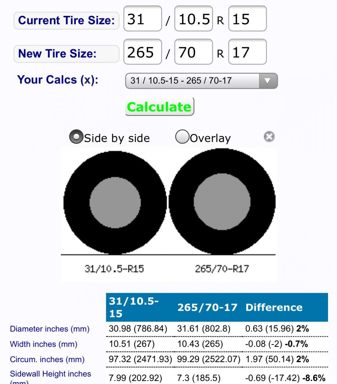

265/70-R17 are pretty similar to the "old style" 31/10.5-R15 tires.
In soft sand, you'll want to run them near 12psi. Without doing any sharp turns or fast speeds. This size of tire is hardly a sand dune master (I've used 31s in the sand a lot). C rated tires' sidewalls will flex better giving more sidewall blulge at lower pressures. A little better flotation.
A "D" should work virtually as well. A "E" is pretty stiff for sand.
