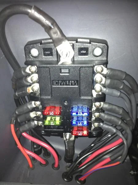

Wire from battery 12v+ to circuit breaker, then from circuit breaker to the accessory fuse box. Depending on the fuse box, you may or may not have a 12v- terminal. I am running BlueSea breakers and fuse boxes in my 80, and those come with a 12v+ terminals which are fused, and 12v- terminals which go directly to the battery. My breaker has no 12v- terminal.
