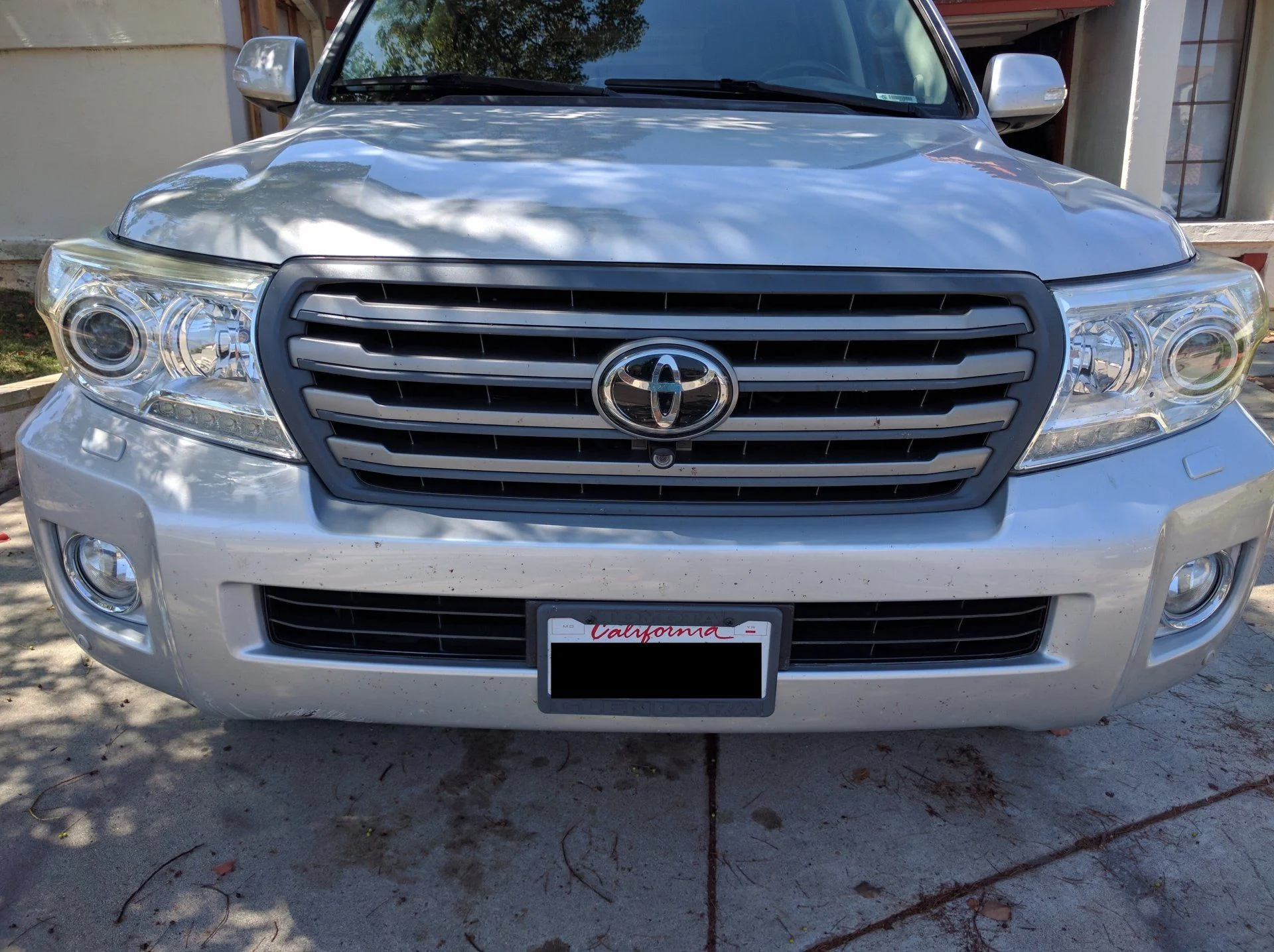

Let us know how you're making out, I was just thinking about re-doing my grill and making it monotone (all black). I used the matte gray color plasti-dip last time to match the wheel and sides but plan to go back to black as I prefer the look on silver. Don't mind all the bug crap in the photo, had just gotten back from a trip when I snapped it.
That looks great by the way. I may just go with the plastidip for the grill (and maybe the rear center land cruiser logo) if you seem to be getting decent life out of it there. Mine is black so I went with matte black for the chrome trim bits described above. Thanks.

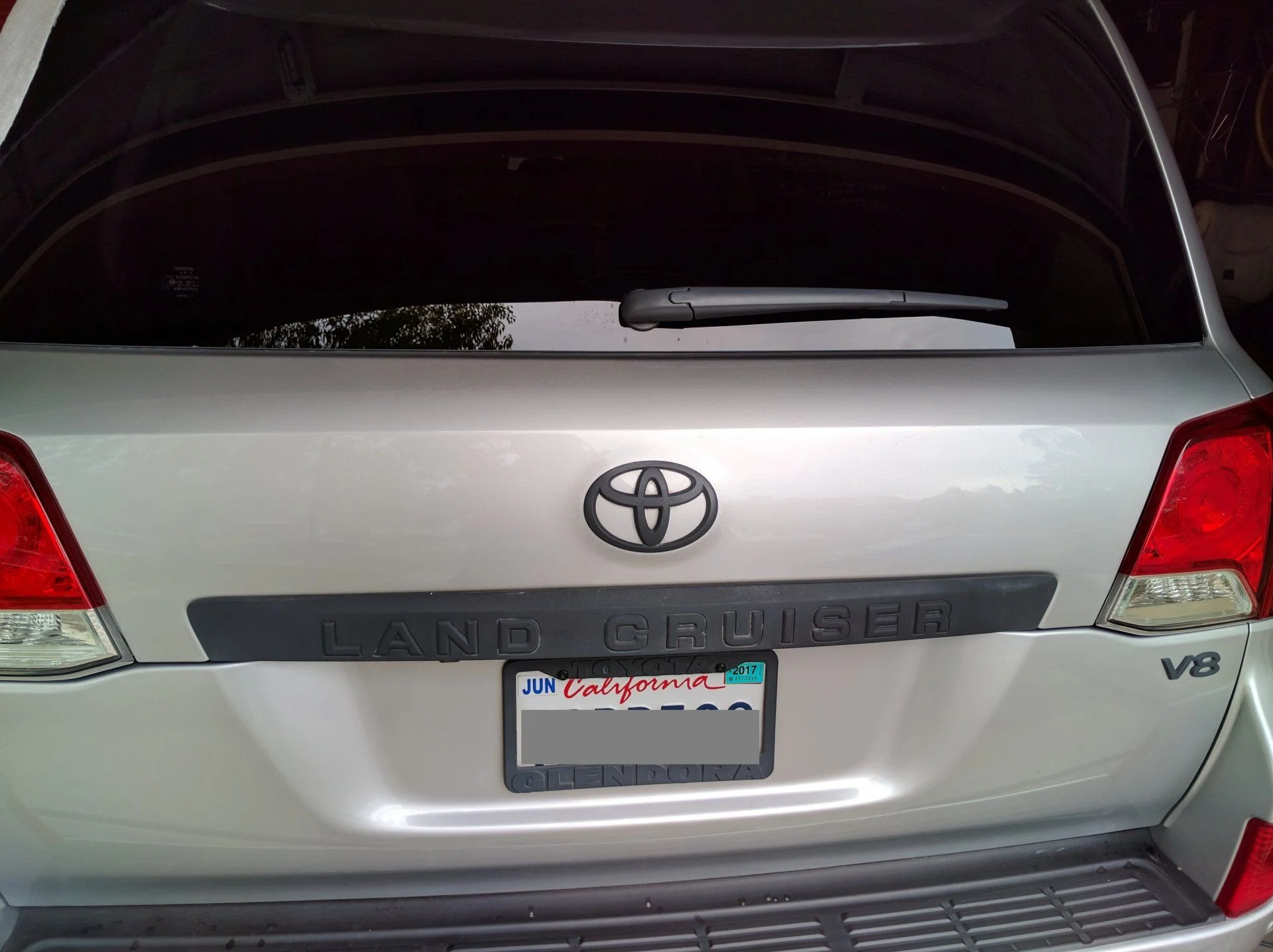

Here's my rear in gray
Here's a current... right now I'm in transition of going back to black. Decided to skip the plasti-dip on the wheels this time and go a more permanent route and used spray paint. The rims had some pretty good curb rash and trail rash so I cleaned them up, but now need to keep them covered since they aren't too perty w/out. Anywho, I'm stuck with the wheels for a while so I sprayed them black and used a dark red shade of Testor's enamel to highlight the sombrero, and then gloss clear coated the cap and wheels. And you'll notice I'm in transition (actually only have two of the wheels done so the other side is still gray), side panels grill, and rear are gray so I'm contemplating what to do with them.
Looks good. So my understanding is you apply a coat, wait 20 minutes and repeat x 4. Is that right? And does it truly peel easily around edges? I would guess getting the emblem so perfect would be a bit tedious.
There are a few threads around here where others have talked about doing an actual paint job on the chrome pieces or parts of the grill. I'd be curious as to the differences, pros and cons, appearance and durability of both approaches. Not sure if anyone has actually done both paint and plasti-dip (either on different grills or the same one) and could give a true comparison but that would be great.
As far as plati-dipping, yes for the most part apply, wait, apply, etc... though I'm not sure 4 coats is enough. For the logos, or really anytime you go along an edge you want to tape off on the other side, and then overspray a good inch or so, that way you can peel that part off and what's left is just the logo part. It was really a lot easier than I had expected and peeled off easily. What you dont want to do is try and tape off everything except for what you want sprayed (like you would using spraypaint).
