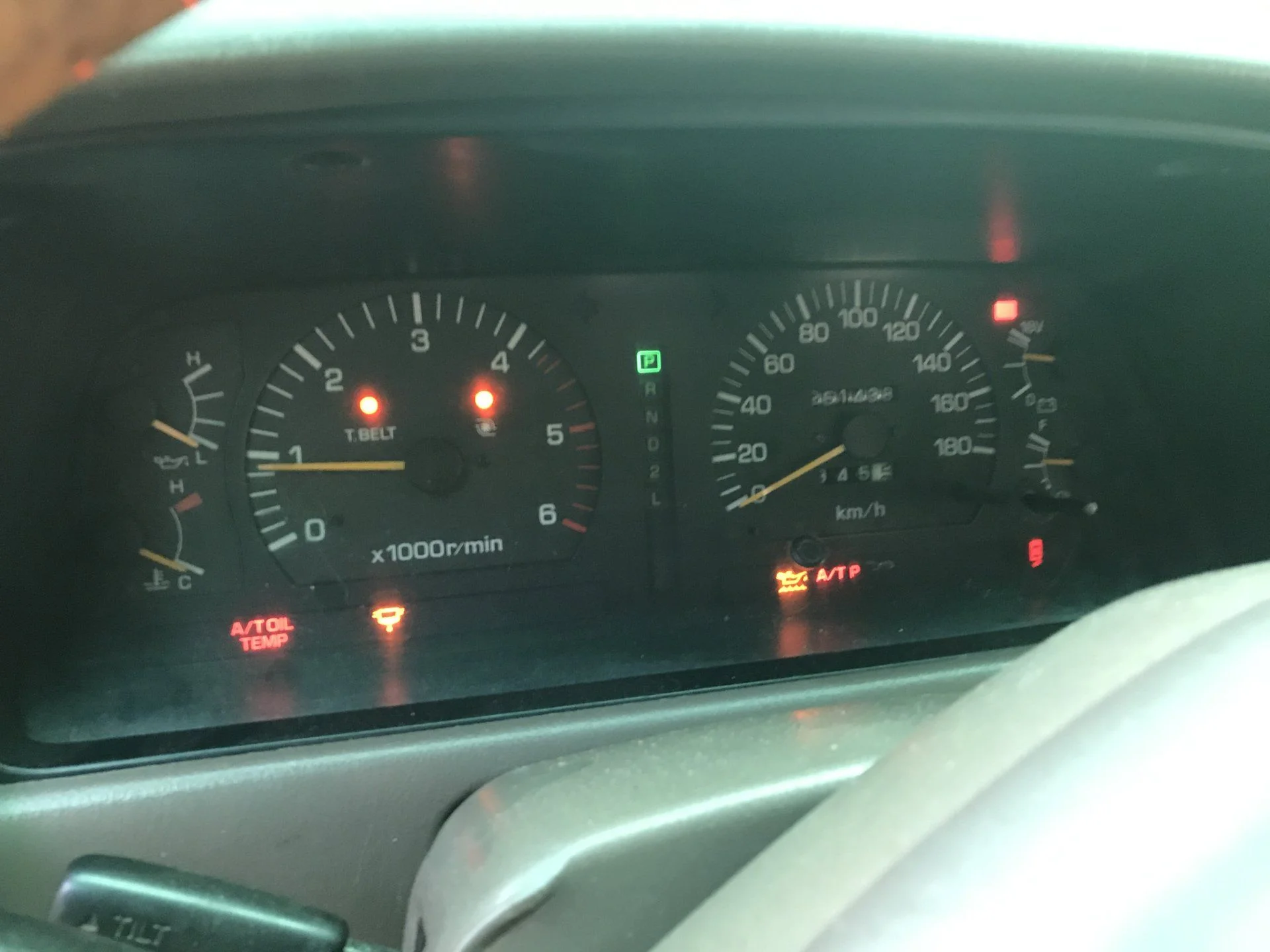

Hello all - I'm a long time viewer and first time poster.
I have a 1995 series 80 from Japan with a 1hd-ft diesel. Love it, but it has many issues. The latest is what I read discribed as the "Christmas tree" fault. My fault indicators are lit up like a Christmas tree. I've read thru the post and most point to an alternator issue. Before I tear into the alternator I wanted to troubleshoot a little so I checked the voltage at the batteries with the engine off and on: off 12.7V / on 14.1V. Seems ok? I also pulled all of the fuses (suspecting a ground fault) and the lights still stayed on.
I've cleaned the post on the alternator and checked the electrical connection in the back. Also, sprayed both with WD40. Any other suggestions before I pull the alternator.
Forgot to mention - the fault started when I picked up my rig from my mechanic. He is not an electrician so he was unable to troubleshoot. He had repaired an oil leak in the cylinder head cover. I am in Cambodia and it is not uncommon to have one repair lead to another - so I am hoping to do more of the work myself.
