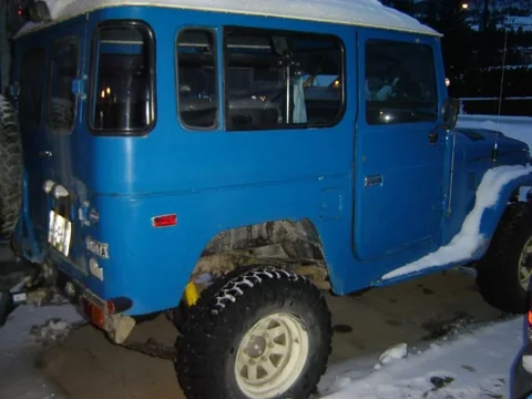

Look what Santa dropped Off...:grinpimp:
I must have been a good boy...
The 8274 Warn Winch is going to need some work (apparently not working) . Truck came with Old Man Emu suspension which is going to be moved to my current lowrider. Rest of the truck is pretty much rusted out and will parted out. So what do you need?

Shouldn't take you long to get used to the color either. Is it a runner? It looks like the same year as yours, is it?
How much higher does it sit than yours?

Not a runner - 3b Engine has lower crank problems and ??? . Rear Tub is beyond salvage.
Yep it's an 82 just like mine...
Trucks sit a lot lower ... as suspension has already been pulled off .;p
