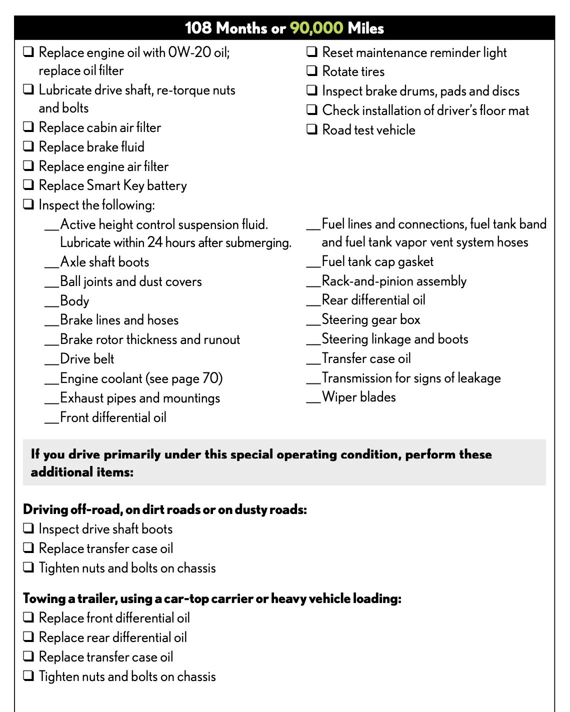

This is a little bit of a digression from my original topic, but I found a 2015 GX with 90k. It's at a dealer who wasn't willing to bargain on price but would work me on service that I thought I needed. For example, he didn't blink an eye at a transmission flush. Is there anything besides below that I should push for?
