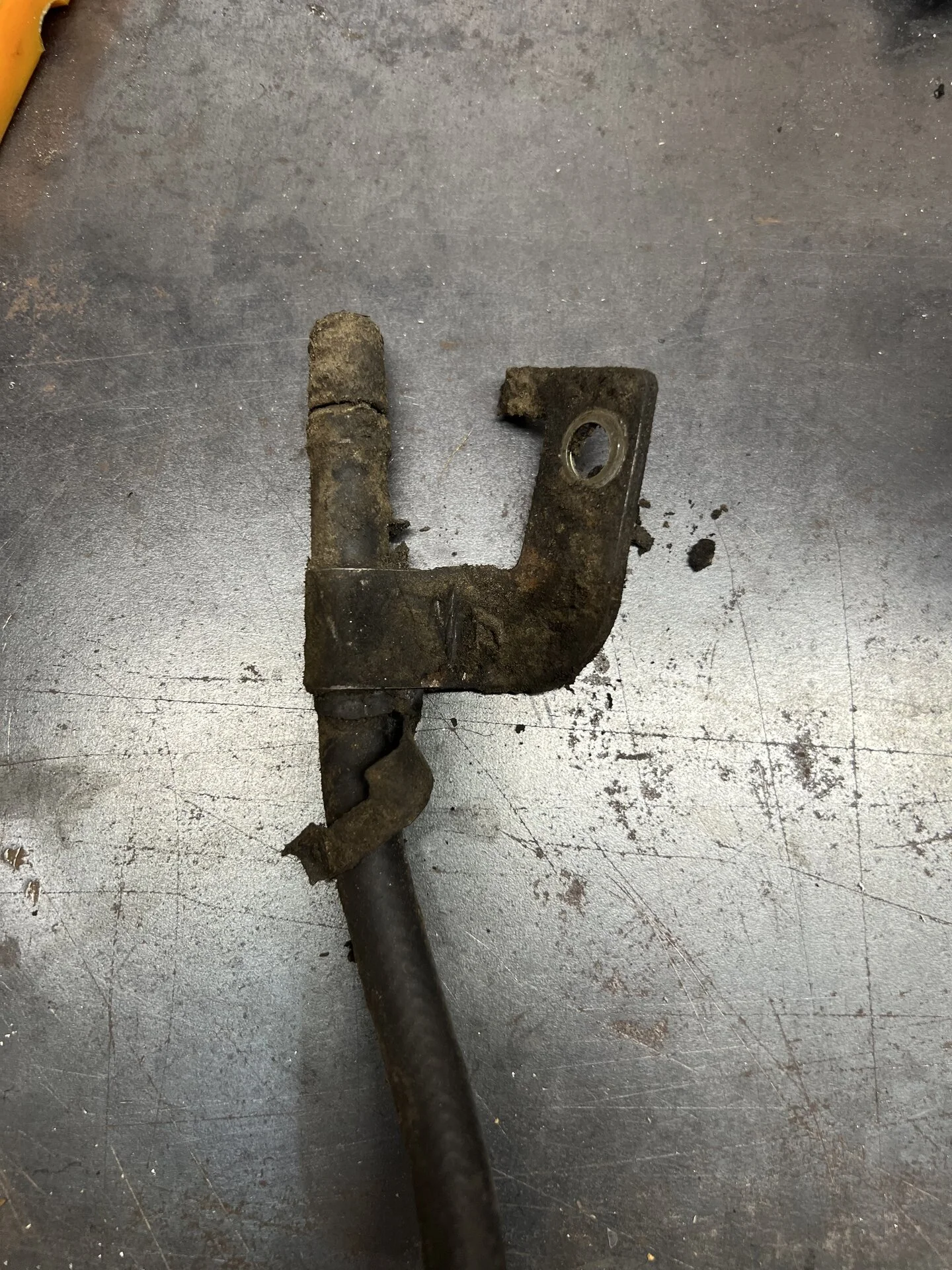

This is the front from 300k miles of unknown service and one weekend of pre-running class 4 roads. I was well over "wading depth" in mud several times.
The rear looked about the same.
Slee installed the lockers under prior ownership, so I assume the breathers were working properly when it was in their shop.
I don't think they were functioning optimally anymore.
