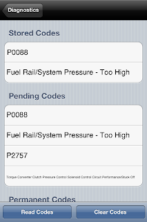

I had a Kiwi Wifi Device and use my Smartphone (iPhone) to reset errors.
There are cheaper devices with cable arround. I had to use the device now 4 times or so, was able to resett errors by myself.
But i have a Diesel V8. It was P0088 Fuel Rail / System Pressure to high / P2757 Torque Converter
I guess it happens from a.) bad fuel or b.) from low voltage of the battery (but just guessing). Then i see that errors only during our transafrica, never before or afterwards.
I had normal Power, but can`t go to 4low before i reset that error code (who isnt the same then yours)

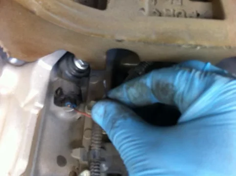

Issue sorted out ended up being cut wire of knock sensor. Wire seems a bit short.... It s a bit disappointing to see such defect leak out on the LC 200. It entailed taking out the manifold.
Code erased with my scan gauge 2....
. image-1069298907.webp Jay
