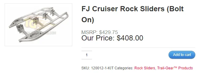

Do FJ's have the same mounting points?
Sliders are one of those things that when I started wheeling they were cheap and now they've double and tripled in price. I'll just make my own when the time comes. I prefer square tubing anyways.
That would have been a great option if the mounts were in the right place. I dont care if they are a little short.
If somebody sold the mounts I could put the rest together. WhiteKnuckle uses a U-bolt mount design. If I could just get the the legs and u-bolts that would get me started.
