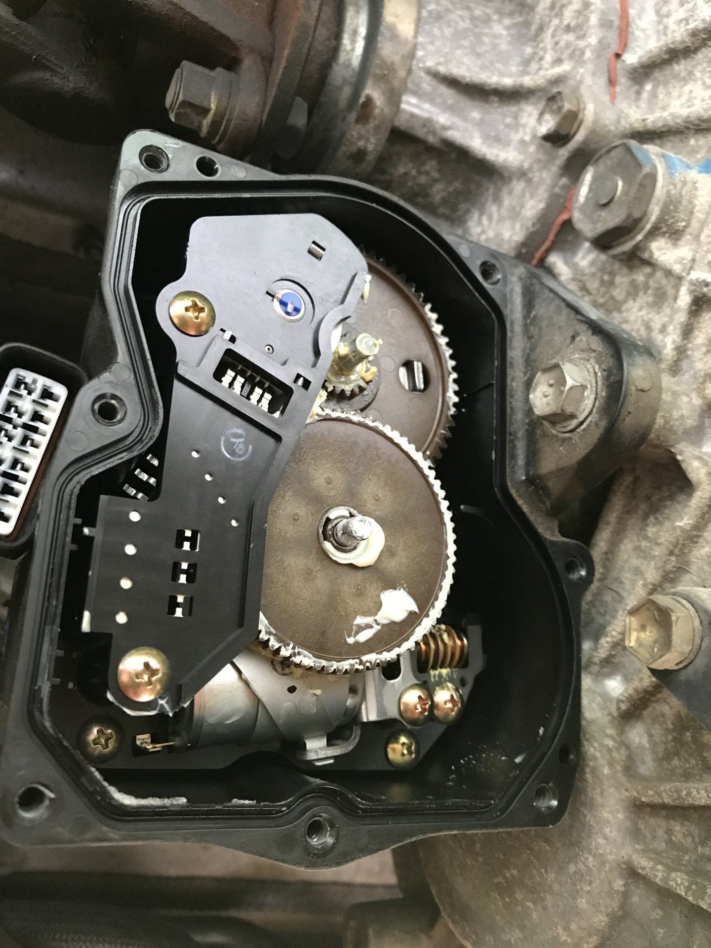

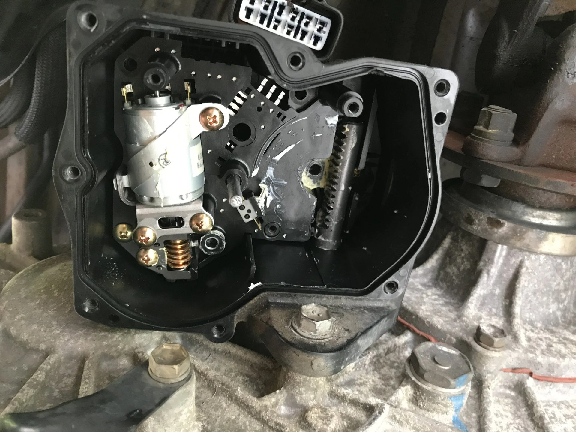

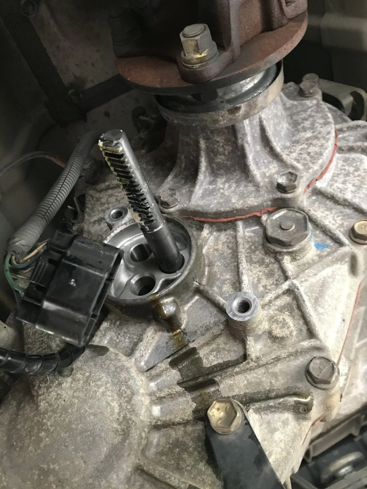

It was stuck in locked position. Shift rod is extended out of transfer case. Pushed it in and it unlocked. The gear that drives off the motor was out of place. I don’t think it will shift into lock again and I didn’t try. I was able to time it to get the VSC light off and cdl stopped blinking. There was a good post on a four runner forum about how to set it

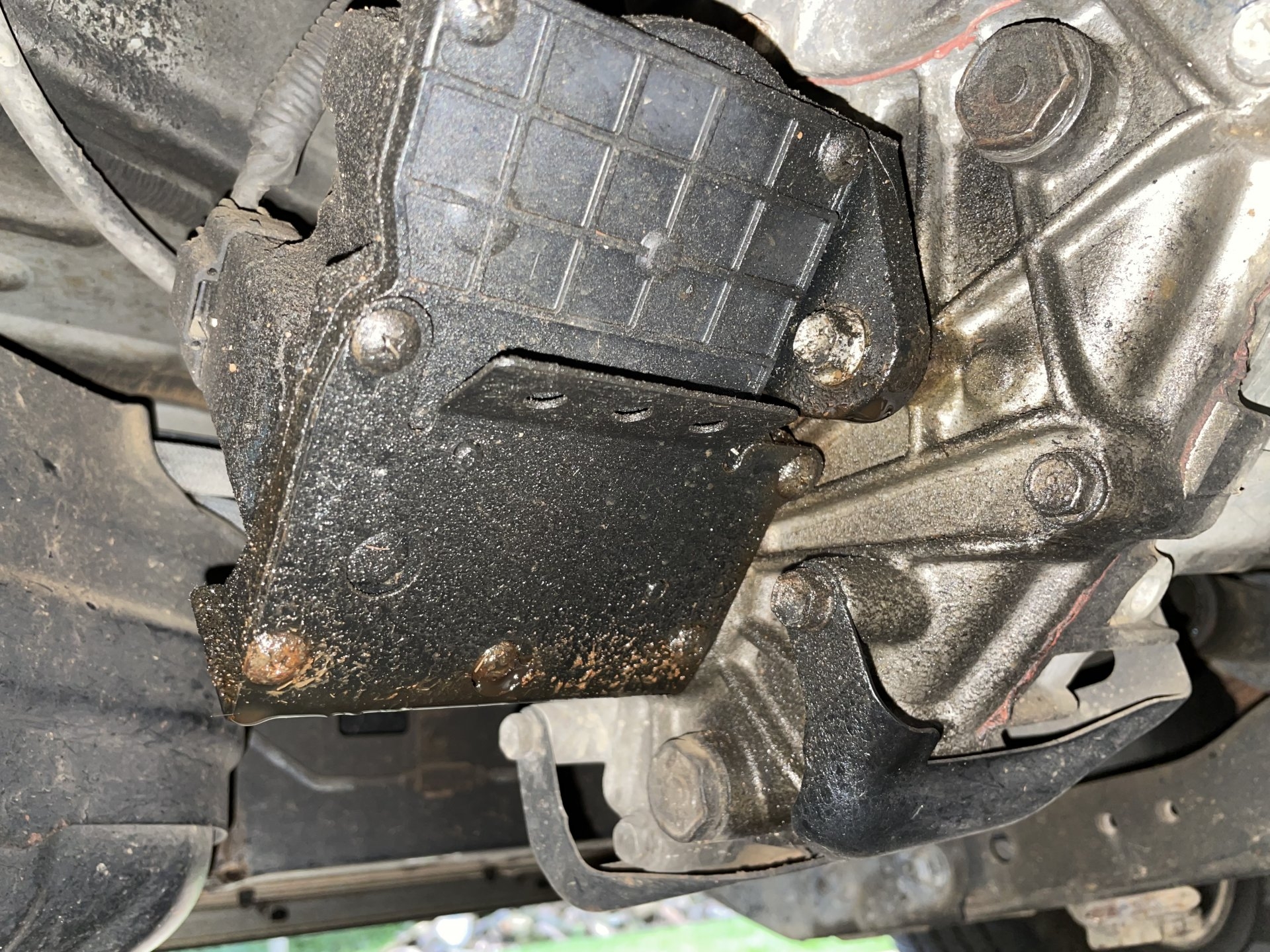

I dont have a locked center diff BUT upon finding this thread I learned that this black box attached to my transfer case is an Actuator?? My LX’s didnt have this.
my “black box” actuator is drippy. Is there a gasket or seal that could be bad?
There are a o-rings that seal the actuator to the t-case. They are a known leak source. The "official" repair is to remove the t-case, and split it in half to remove the seals. There are several very good, detailed write-ups on how to replace the o-rings by just removing the actuator. There are also some videos on Youtube showing the process.
