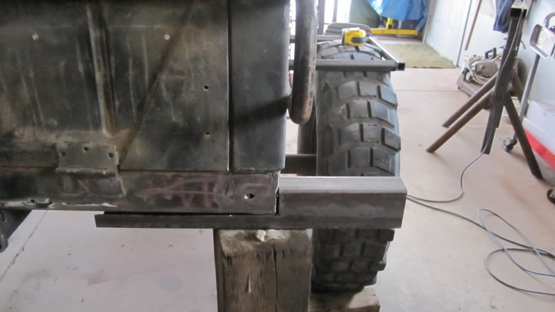

I was getting tired of lifting everything up and over so today out came the cut off wheels. After getting sprayed with black, smelly tar like substance from the 1" tube all went well.
I cut the corners about 3" in and backed them with a piece of 1/8" thick 2" flat bar for the stop for the tailgate. The top of the trailer also got reinforced with 1" tube. I also welded the whole length of the floor to the frame. I didn't do anything with the bottoms of the corners as I think they are plenty stout.

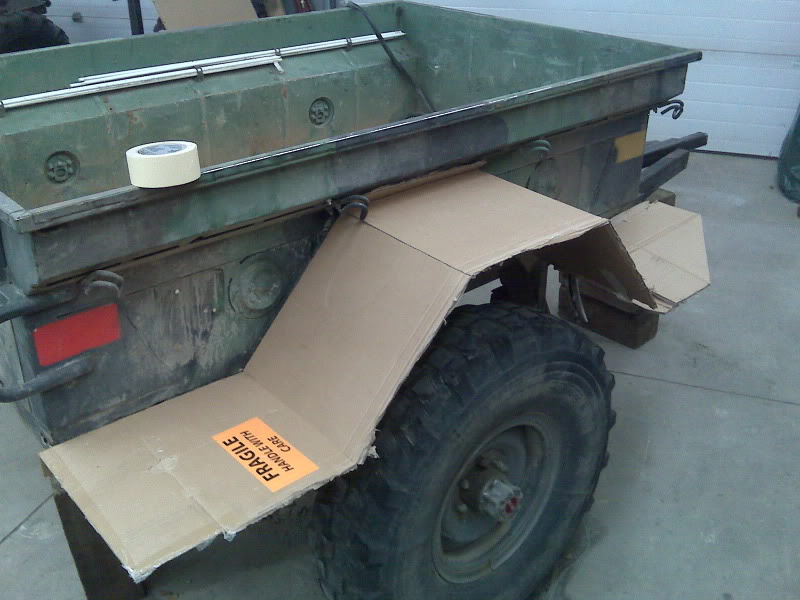

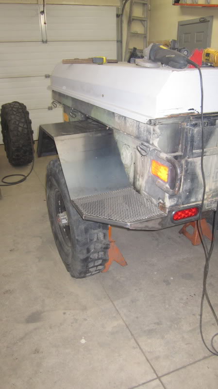

Wider fenders to cover the tires. It will also can a fuel can on both front side steps and a propane tank on the rear step

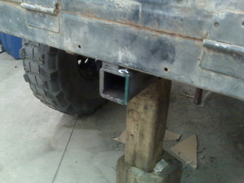

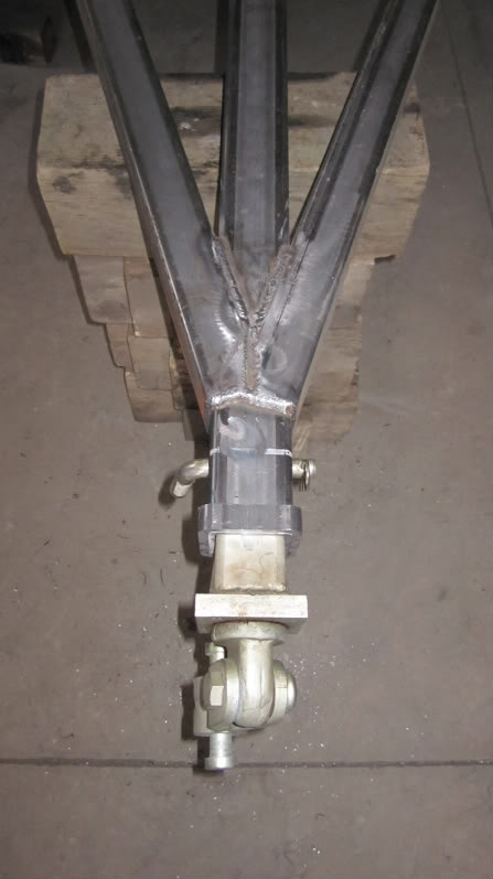

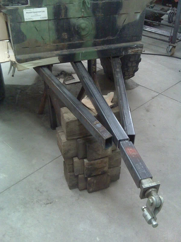

Rear hitch mount. The tube runs the full length to the front coupler. Can be used for towing someone out of a hole if needed, also to carry a bike rack.

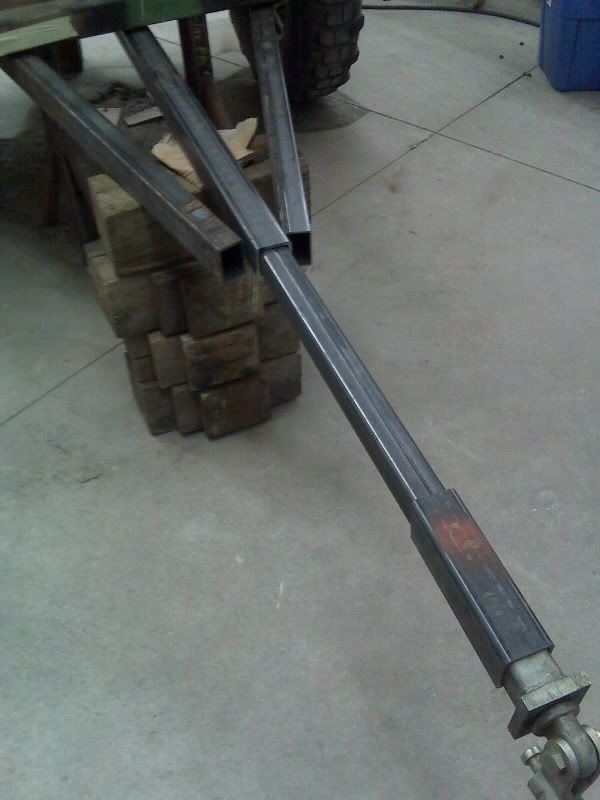

New receiver and arms. Fully adj with about 4' travel. Battery box will also go up front.
Got the hitch done

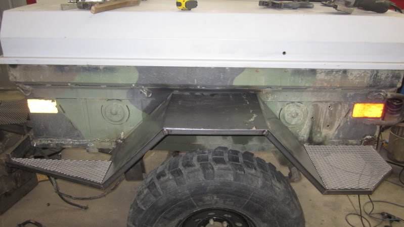

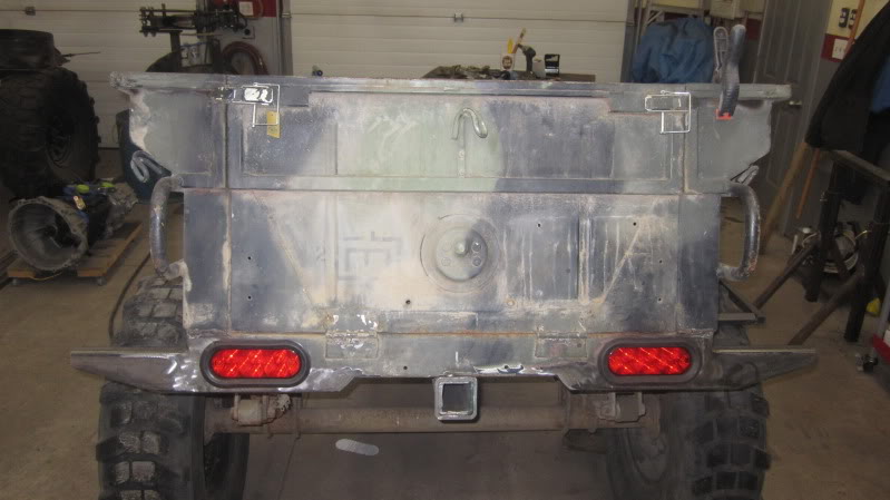

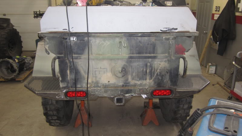

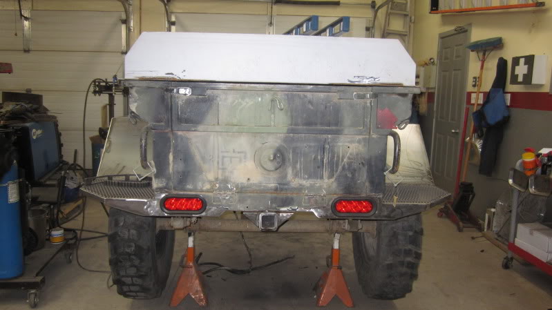

Working on the rear bumper/lights/fender combo
Not exactly how I thought it was going to turn out but I am happy with them. I just need to add some gusseting to the receiver and start on the fenders:

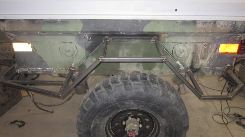

Making slow progress.

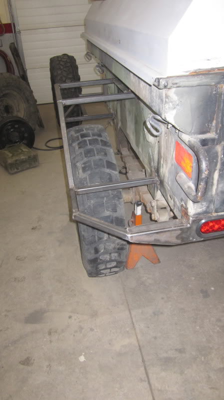

Fender frames are welded (just need some grinding) and the sheet is bent and needs to be fit and welded up.
15" fenders are WIDE. Yikes.

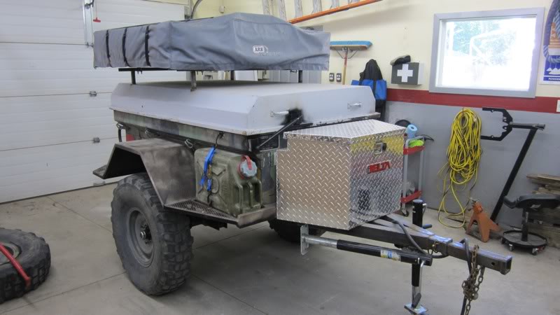

Some more progress pictures. The fenders are basically done. I just need to add some straps to hold down the NATO cans.
Next step is wiring, a removable/swing down leg, and getting hinges on the lid.

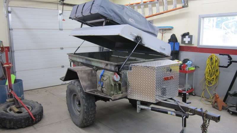

A few more updates. I am getting close to taking it all apart and blasting and painting. Thanks to Ryan I have a set of struts attached to lift the top! The front strut is on the out side of the trailer and rear one is inside the box. This was to retain the tailgate and not run into interference when opening it.
If anybody wants to learn how to change split rims, come on over, and bring a high lift jack... I can't get the bead broke on the one on the floor. I would love my own tire change monkey.

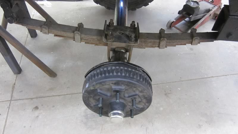

I also got the new axle underneath. A 3500lbs, 10" electric brakes with 6 lugs hubs. Still needs to get wired up.
A buddy is bringing me some batteries for the front nose box. Hopefully I will have it done by the end of the weekend.
Which nose box (model #) is that? I have seen it used on several rigs but don't know that I ever saw an exact listing for it.
