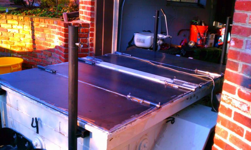

the 1 and 2nd pics in post 14 are the way it will be traveling for that is the lowest position which is about 18" from lids to bottom of rack pole, and lifted when camping goes up about another 12" I guess? I will try it out soon for I have never even pulled behind BJ42 yet since it is not finished being restored but super close now. I will post back how it does, the rack works really good with the locking pins on each corner when in up or down position and the gas springs are great.

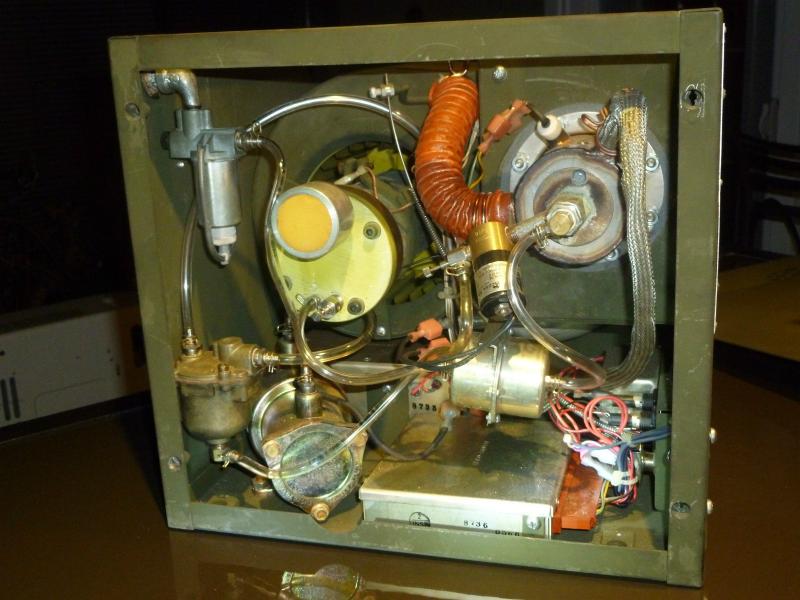

picked up a few things for the camp trailer. NOS Military 15000 BTU mutlifuel heater runs off either 24Vdc or 110Vac. Also picked up these Military amphibious vehicle aluminum steps that I will place somewhere to make it easier to sleep on lid of trailer. Having a local canvas shop make a snap on tent type system for underneath the RTT when it is raised therefore I can sleep one more on lid which will have big zippered screen and solid windows. Now I am looking for a very small window A/C unit for summer months that I can plumb flex hose into both RTT and underneath sleeping area.

thanks, I havnt put seals in yet to truly weatherproof it though everything underneath is in military aluminum boxes with seal and pelican cases so if after I do put seals in it still leaks a little I wont be too worried. it is heavy but yes sturdy. I found a perfect mattress that fits the correct length and as wide as the vertical poles are set apart and it will raise high enough in camp position so that someone would be able to sit upright under it. it now sports BF Goodrich 255/85-16 tires to match cruiser as well.

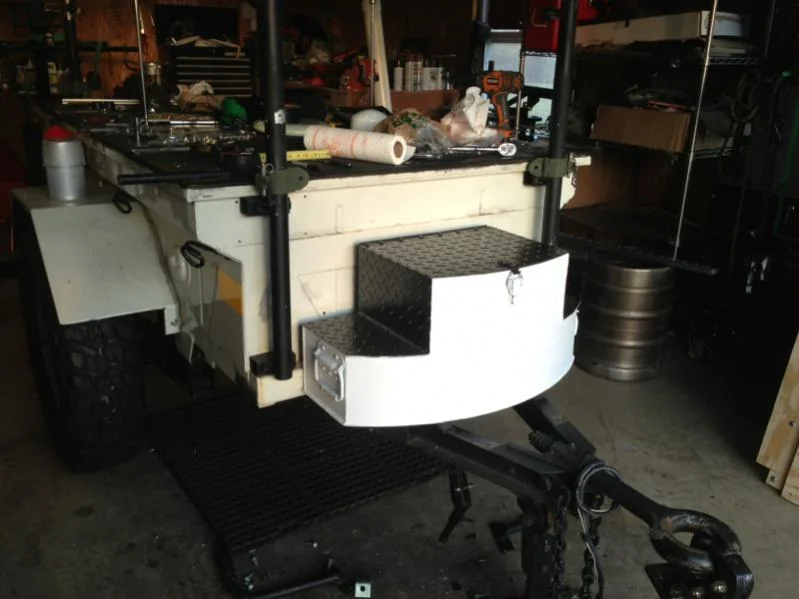

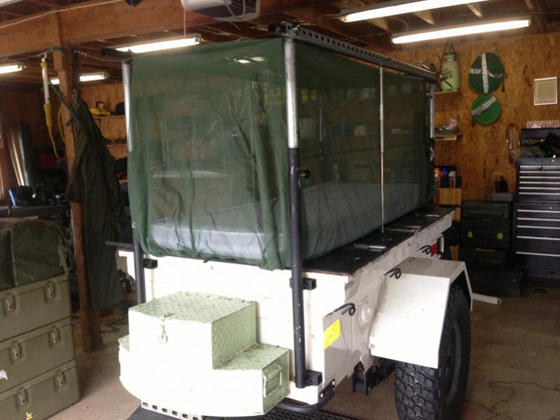

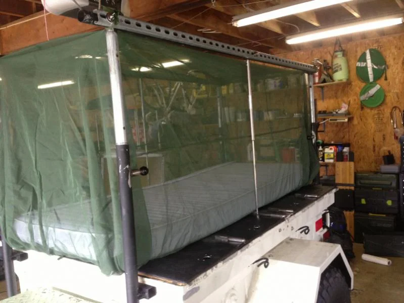

Got a little more done. Installed a nice aluminum tongue storage box after I sandblasted and painted (still need to paint face of with vehicle color), test fitted a military cot mosquito net for this summers Florida keys camping trip on beach coming up, it fit perfect and will have a canvas shop make a black canvas flaps to cover all sides completely when RTT raised and tent is deployed above this sleeping area. Trimmed the fenders because the 255/85-16 tires were dangerously close if I was to hit a big bump, installed Kanz kitchen hanging brackets on rear of tailgate, mounted license plate on fender.

I like that nose box with the built in steps. Any idea its original source?
Coming along nicely.:beer:
I wish I did, I found on eBay from a seller in which he only had one but he deals in a lot of military surplus. It's heavy aluminum and perfect size for the CDN M101. Sorry, there are no markings of mfg on it
