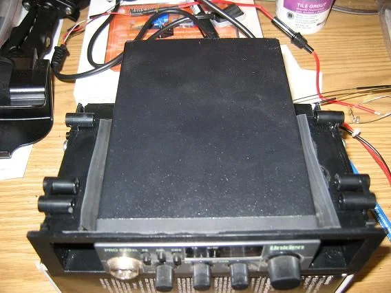

First, a huge thanks to Mo for cutting a piece of plastic last week and to everyone on Mud that's posted anything about radio installs and removal. Finally put my Uniden 520 in the dash.
I had a single din radio put in a little while ago and watched the installer like a hawk during the installation preparing for this. They had originally put in a single din storage tray under the radio. It was shallow and useless. I ordered a second one for all of $25 shipped to 'play' with the idea I had for installing the CB and it worked, so if anyone wants a cheap single din pocket for their cruiser, I've got one cheap.
What I did was cut out the top and back of the plastic pocket to fit the CB. First trial I flush mounted the CB to the pocket front and drilled into the sides where the screw mounts to the CB were. Very solid, but as I installed it in the dash I found that even with the right angle connector for the antenna wire there wasn't enough room, so I pushed the CB out to flush it with the radio front and test fit it before drilling a second set of holes in the side of the pocket. Worked like a charm. I had to dremmel out the holes on the metal mounting bracket for the radio, but it's very secure.
Mo had some plastic he'd purchased from Orvac that he used to finish trim his install. It had a smooth and textured side. The textured side matched almost perfectly to the pocket front. A little epoxy to the back of the pieces before the radio install and I had a very finished look.

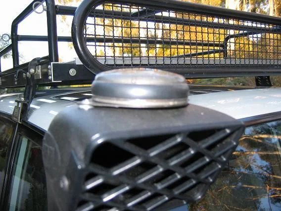

Here's the GPS/XM antenna on the snorkel. As it's just a magnetic mount, I'll probably zip tie it for off roading where pinstriping and branches are probable to keep it from getting knocked off. I just routed the wire down the back side of the snorkel, thru the door jam into the engine bay and thru the rubber grommet. Wire is encased in wiring loom and secured with several 14" zip ties.

Glad those pieces helped out Brent. Looks good but the right one is a little short. :flipoff2:
Na - f'ed up the second cut and the bastsard that gave me the plastic free of charge didn't give me enough to f up once and have enough for a third try. He should know better! Actually, thought I'd scribed the piece just a little long, even accounting for the hacksaw. Only measured once.....hmmmmm measure twice and cut once dummy!
I still couldn't be more pleased with how much cleaner the entire center console is now. Actually thought I'd scribed the second piece a little long even accounting for the hacksaw. Only measured once...........measure twice, cut once you dummy! Gap is nothing a little black shoe polish would hide forever and it's really just the flash of the camera that really exposes it. That and a perfect eye from MO!
Panicked when I first turned on the CB. Got NO squelch at all. Thought - damn, the speaker must have come unplugged on install or final push into position. Called Stan to the rescue the next evening to test it. On the way over, I caught some chatter and knew all was ok, but tested both transmisison and receipt with Stan and everything was fine. Just waiting on the dash lights dimmer from Dan. I have no dash lights w/o it. He's sold a few, but didn't have one in stock. May or may not see it by Friday. If not - absolutely no after dark driving for me this weekend.
Actually the piece I gave you was 1" x 4" even counting for the blade thickness would give you 3 tries. :flipoff2: I meant to give you enough for 4 tries but I was a little out of sorts and screwed up.
You are correct, a little black paint or shoe polish and you are good to go.
