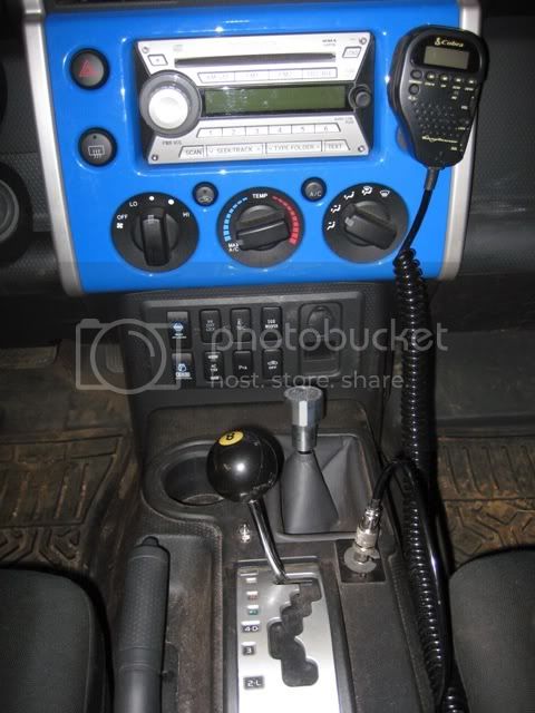

The great thing about the 75 is that most of the radio is in the mic and the rest is a small box that can be hidden anywhere. When not on a group trail run, you just unplug the mic and have nothing taking up space until you need it again.

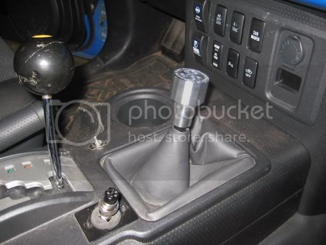

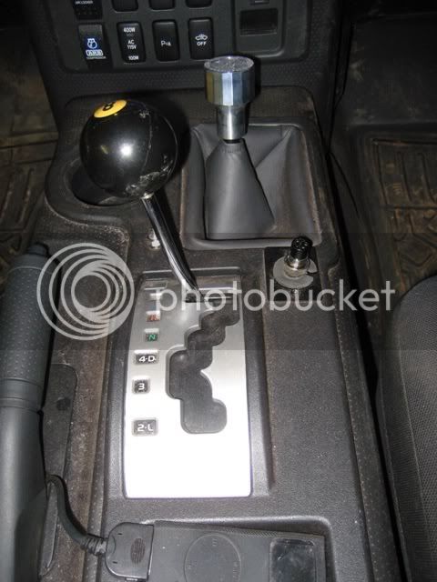

Here is one installed in my FJC:
When unplugged, there is only a socket plug left on the center console:
