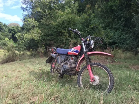

I do like the old agbikes I have a yellow ag200 a red ag100 and 3 Honda ct200 auto ag's.
I've been thinking of getting Suzuki tf125 there under 3grand brand new same design as they were 30 yrs ago I see that as a good thing
I would like a sheep farmers view. I'm a 2 stroke fan by the way
i can talk ag bikes cat.
i run a lot, but they never all go at once haha. last summer i had 9 going; something of a record for me! mostly suzuki. tf125 are a great little bike; got a couple. would like a new one. we got an old bloke who has worked for my family most of his life. he likes the 125 now because they are easy to kick and light to handle. would love to present him with a new one to treat as his own see out his days because he has spent his whole life tolerating whatever station bike (and horse before that) was available. got a few tf185 also; dunno why they still dont make these. tf185 were same motor as the er185.
the 4 stroke 'trojan' ag200 is prob our main bike, the one i most familiar with, but they too have issues. the starters fail early, the rear wheels collapse (tf185 rears fit), and you cannot run them without a battery which is annoying. what happens is a kid tries to start a bike on a cold morning, doesnt have the kickpower to make it fire and leaves the key on. summer and dead batt by the time i find it! carb needs a new emulsion needle every 15-20,000km. and the crank key that holds the magneto has a tendency to shear; easy fix with the right puller. carb and this key are the death of most the ones i find. we gear up the sprokets to give them more legs, invert the rear brake so the rod runs above the swingarm instead of getting smashed to bits under it and fit a piece of conveyor under the crankcase. without the rubber the footbrake pedal has a tendency to pick up sticks and drive them through the oil sight glass which is a walk home with an oily boot. got a trojan with 57,000 hard km on it now.
yammy are ok. got a 175 2 stroke and a couple ag200 4 strokes. many blokes here swear by the 200 but they tend to bug me. had a couple cdi units fail which took me forever to diagnose. still got one bike that when hot will not idle or start (no its not valve adjustment). the clutches give trouble (going to try brand new clutch springs next). and yammy fuel tanks rust out from the inside. they must be thinner and more prone to rust than the suzukis. prob need to put a bit less water in my fuel. i like you can run yammy4str without a batt and i like the yammy sealed chain (they last longer).
but the bike i am going to build for fun is the original orange ag 175 from the early 70s. had one as a kid and got a couple wrecks (the other buried in a shed and too hard to photo) and a couple more wrecks around the district to pick up. got a good motor and good tank stashed in the shed. thinking budget spraycan rebuild. popular bike in their day but extinct. bright orange and loads of chrome barwork; they look so dated now. and who else would 'restore' an old ag bike haha. ridiculous project that suits my sense of humour. but look perfect on the tray of an old fj45 i reckon.
Cult there will be no power steering on this old girl
Looks like a tf125 will be next bike purchase thanks westaussie, I don't know about the ag175 looking outdated I don't mind the classic look

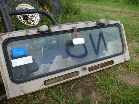

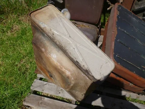

a few weeks ago I came across a 1965 fj45 that was waiting to be scrapped, the very generous owner let me pillage some early trinkets off her.
as you see a vented windscreen frame and square fuel tank plus a heap of other stuff that will come in handy when I do my 63 fj45
Nice save cat. Not sure what techniques you employed but it might be time to move into sales ;)
Ozcruiser it was already sold to the scrapper, had 2f and later model chassis
Cult me mate, all above board
Sales haha Im in the collecting stage. Once I get my 63 finished might sell of excess stock then again I'll probably have something else to use it on hehehe

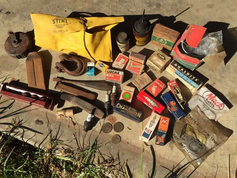

Reading sneakys post about previous owners, I would have liked to have met the old man that owned this 72 model.
Here are some of the interesting items I found in the junk stuffed behind the seats and in the glovebox, old stihl tool kit, hytest wedge(pitty wasn't a hytest axe), tropical greenlite matches, caterpillar, mack parts, old spark plugs, old time D shackle
What a score!! Love that old time stuff.
