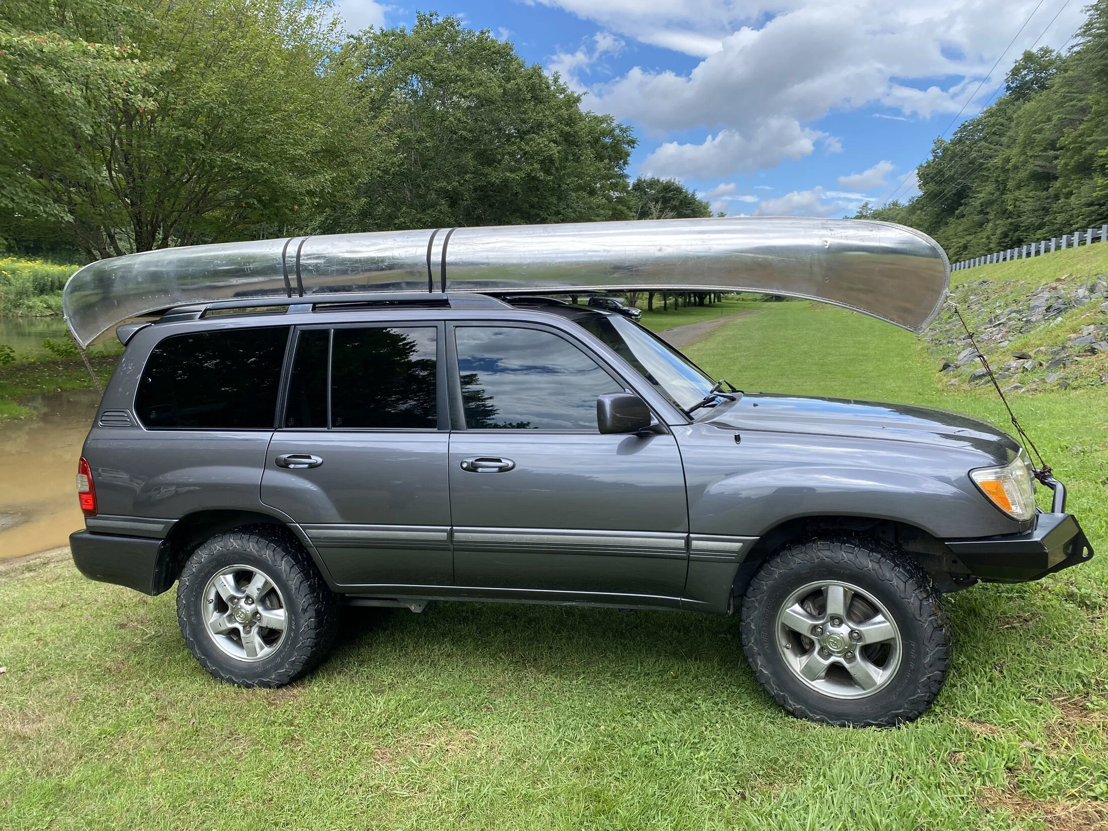

17 ft aluminum Grumman. Hauled many times in the factory rack. Two canoe/kayak straps on the cross bars and bow & stern ropes on the end (but not sure 100% required). Loading and unloading has scratched the black finish off part of the black-coated aluminum cross bars on the rack. But no one can see it.

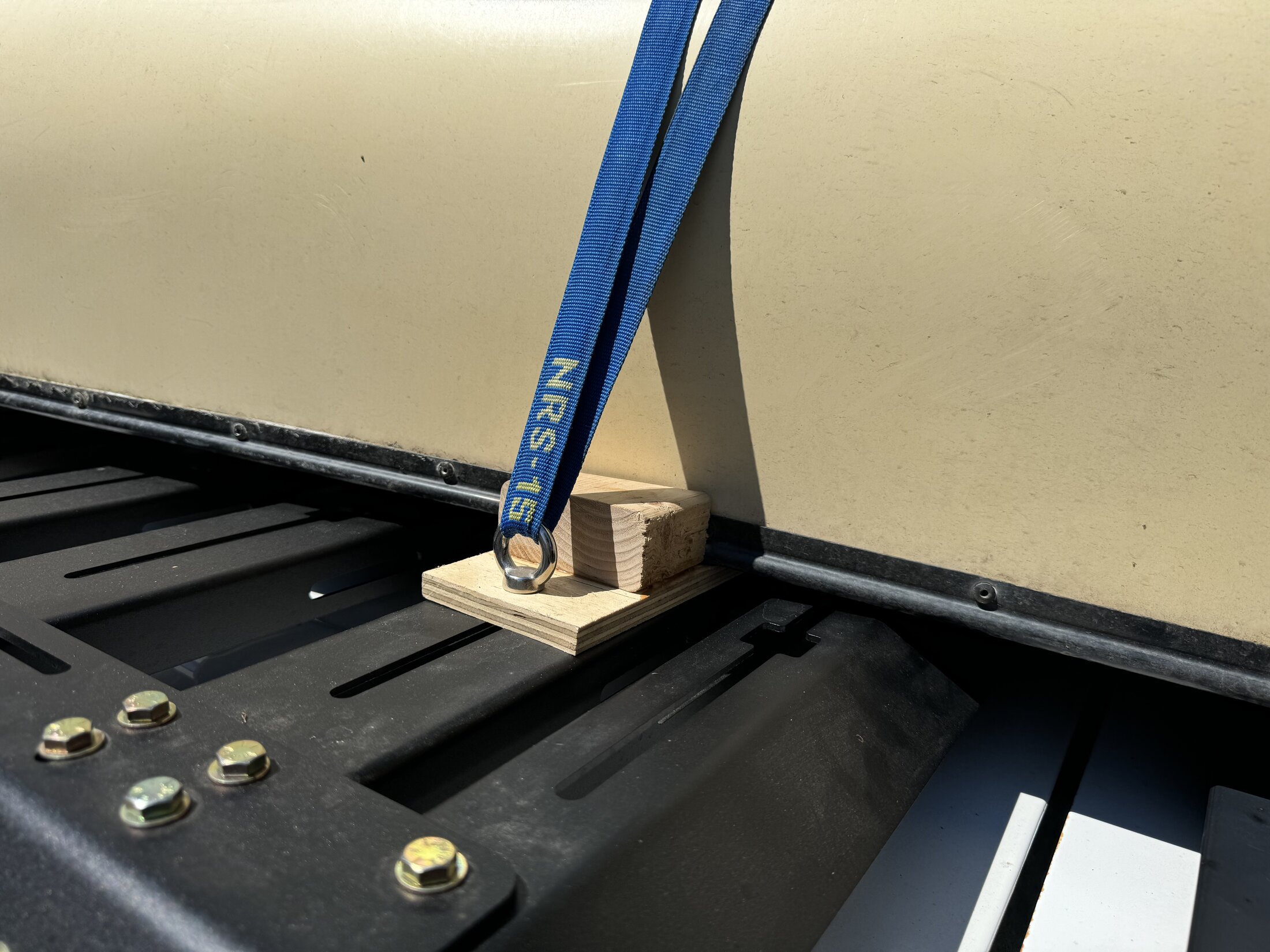

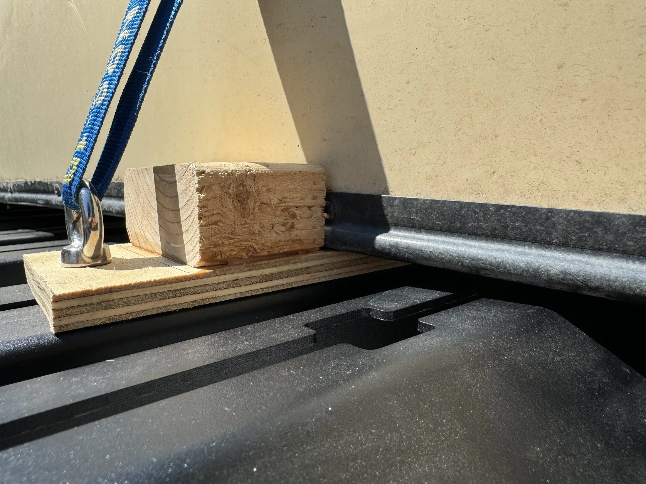

Just mounted mine for weekend. Different rack, same idea
Just FYI, with that detail it is putting a ton of stress on the eye bolt (trying to pull it out of the rack). Regardless of the eye bolt strength, it would be a more stable connection to loop the NRS strap around the bottom of the cross-bar. Then you aren't relying on the strength of the eye bolt (which is being eccentrically loaded as-is) or risk of the nut backing off and are instead pushing the canoe into the rack (as the crossbar is many times stronger than the eye bolt and you would break the strap well before harming the canoe or crossbar). You might need some kind of a sheath around the strap for that connection detail, as your crossbars have sharper edges than an OEM crossbar. For a rounded OEM crossbar you can go sheath-less with a NRS strap. You can probably also skip the wood if you wanted, but it does not hurt anything (the gunwales on my canoe are already chewed up).
Fair point! the edges were the reason I didn't just wrap it around and I had to find a solution in ~1h :-)
Got to think it through more I guess ;-)
