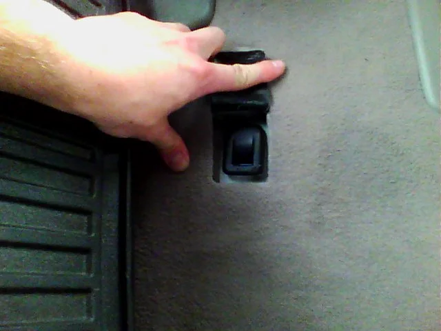

When I did this I discovered a hot patch in the cargo area. right behind the Right Rear seat/above the RR tire my carpet is extremely hot.
I have been doing research and I understand this area is known to get hot. Mine is so hot that is is burning the insulation between the carpet and the body.
I can say this because this area does not match the elevation of the rest and is soft/thinner than the rest of the trunk.
This area is so hot that when I touched the metal hooks for cargo tie down I burned my finger.

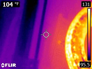

This is the small heat shield I can see above exhaust. I measure exhaust at this point to be 180F after about 3-10 minutes with engine off.

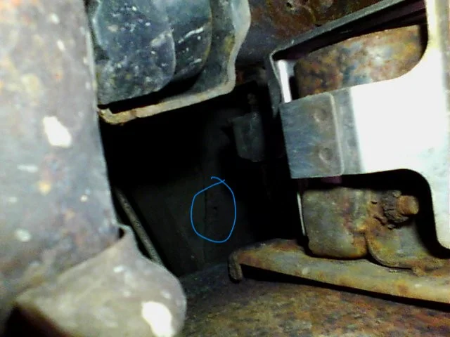

I see this area above the rear of the muffler. I noticed maybe a bolt is missing here. I have not found a good reference photo yet.
Does anyone know what goes here?

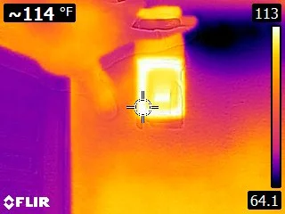

I am getting 140F for temperature on my Flir camera here. I think it may be picking up the 300+ muffler though.

My first thought would be an exhaust leak or missing heat shield. Considering you were dealing with rust has the heat shield rusted away we’re just out of position in thatyou say it might be missing a bolt
For anyone interested. I have officially discovered the issue with the excessive heat in the trunk. When I took a look at my muffler, I could see it was old but did not realize the entire top had peeled off. So I now have partially melted sound deadening and a mechanic with a burnt hand.
Issue = Solved
