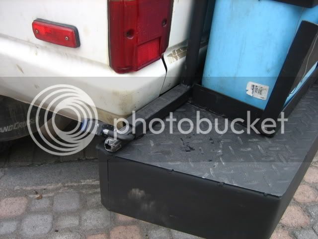

Just had this beefy cargo-carrying bumper custom built, and I'm pretty stoked about it. These guys built the bumper, the swing-away jerry can holders, and the fold-down strong box all for $260 US!
under construction...
finished, and full of stuff
20L jerry can holders can both support an extra can strapped on with handy fold-down flap... currently secured with wire :p
The can holders and the box are all secured by a single metal pole that slides through a receiver at the back of each object.
pole locks at the end, and nothing can move while it's in there...
strong box opens from the back, so you can't open it unless you can fold it down... requiring pole removal. also adds security for my back doors, as they're blocked from opening.
ship's cat. necessary for a long expedition...
I walked into this little welding shop with no plans whatsoever. They built it exactly to my specifications, as I came up with them off the top of my head. I thought it was pretty impressive!
This should free up some space inside the vehicle, and make it a bit quicker and easier to set up camp at night. Also, I can now merge as I please, striking fear into the hearts of even the fiercest of south american motorists...

interesting. Why did you have it stick out so much in the back and on the sides?
I think even when its full of gear you can still use it as a step.
At the back I wanted it to not be way farther in than the box... I wanted it to offer protection to the box and the jerry cans as well. For the sides... well let's just say they weren't exactly the measure twice cut once kind of guys.
Also I designed it big because originally I wanted additional storage inside the bumper... they didn't do that, but I'll probably have it added later.
yeah actually with the jerry's swung away and the box down, I want to give it a little leg or something so we can sit on the bumper and use it as a table. This morning we witnessed a family having breakfast on it, where it was parked.

About the bar, can it be removed to either side? I can see potential problems if you are in a confined space.
Looks good. I like the added security via obstruction.
Yeah well it can be initially slid in from either side... I was thinking of just adding another hole and having padlocks on both sides for that reason, but my truck is way too covered in padlocks as it is. I just try and think of it before I park.

I forgot to ask but how much do you think it weighs?

Functional, how are the swing outs mounted exactly sans a spindle?
Err, exactly that, functional. There is one large steel tube welded vertically, and the jerry holders have a smaller one on the end of the bar that slides down inside. It actually works fine.
I'm sure some day I'll have it done properly, but for our purposes this is cheap and works. Adding spindles would have been a major communication issue, as well as irritating my welder guys, and increasing the project cost by what... 50%? Also, my time budget said no to finding parts.
As for weight... who knows. 400lbs? You can lift the bumper itself on your own. Full of stuff in the box and filled up jerry's? I dunno a lot. I had an extra leaf added on each side in the back before having it built. I'm sure it would sag like crap otherwise.
