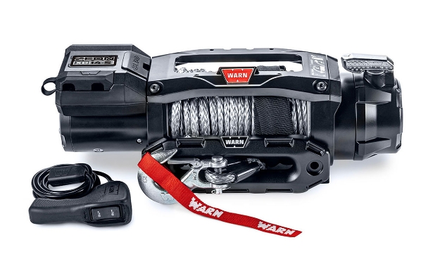

I optioned for the Warn Zeon XC 14-s. It is a new design with smaller foot print & sleek control box to help better fit in hidden bumpers.
I was able to catch a special discount on the Warn but it was still about $300 more than the Carbon. Slightly less if you throw a F55 fairlead on to match the Epic fairlead that comes with the XC.
Had I been able to find more real world reviews I may have gambled on the Carbon but most of what I found was marketing reviews/promotions. Even the Aussie group on Reddit didn’t have much feedback.
Some things I like better about the Zeon XC:
- USA engineered, assembled & tested
- Cone brake
- Bus bar electrical connections
- Wasn’t really “that” more expensive w/ discount
- Stronger reputation for reliability & longevity
- Better customer service (talked to them a few times before buying & it’s a night/day difference on finer technicalities) — will say Carbon email response time was fantastic
- Better parts availability at more locations
Still waiting for it to arrive. So will hopefully be able to provide some more useful review once it’s installed.
I might add in both scenarios I liked having the slightly larger 14k+ capacity. Right at 2x GVWR in my case. Gives me a little cushion on the rope layer count without having to complicate rigging trying to get down to the first layer for max capacity.
