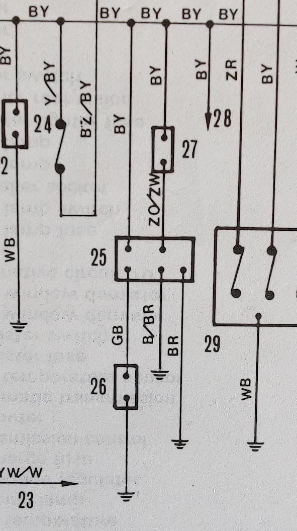

This ecc has a 5 pin connector and is wired as beliw (25 is ecc, 26 is vac switch and 27 is 2-wire fuel cut solenoid):

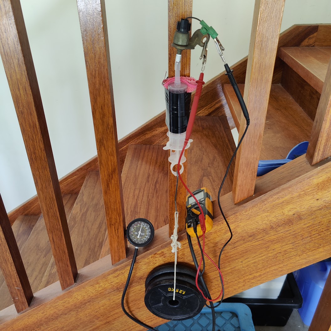

The vacuum switch was grounded with engine off, and I was curious at what vacuum the switch would open and break the connection with ground. I fabbed a little rig with a sturdy syringe and suspended weights off it to create a controlled vacuum on tge switch:
Appears the switch opens at around 16” Hg. That means that when driving normally with a vacuum of 19-20” the vacuum switch is open which the ecc sees as the engine not being under load.

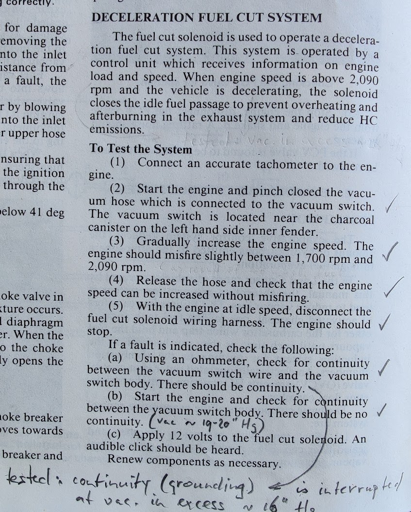

Posting Gregory’s manual for testing the decel system for info:
So the entire system functioned exactly how it should, cutting fuel not needed during deceleration.

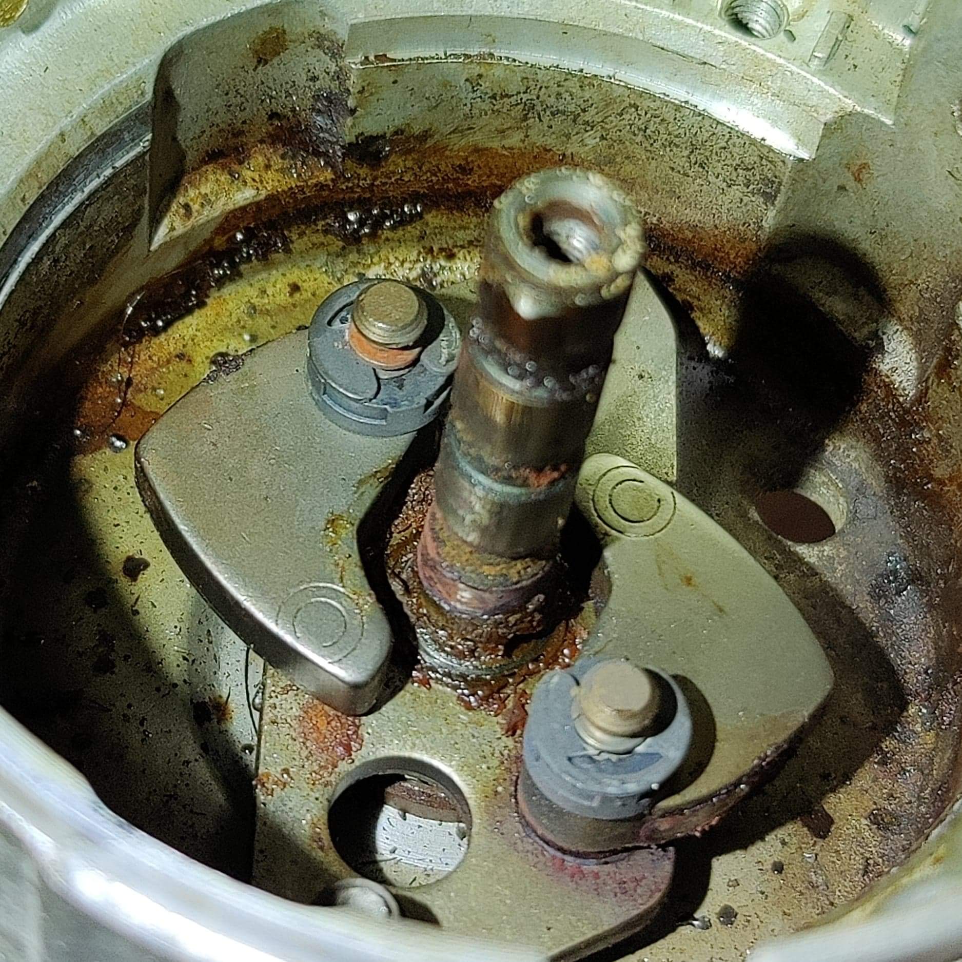

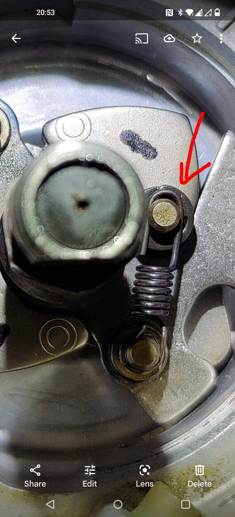

Before giving the suggested timing advance increase a go, I decided to pull the dizzy (19100-61160) and check it over as a matter of eliminating possibilities. Found it to be pretty gunked up, to the extent that when extending the governor springs by pushing the weights out, the springs wouldn’t return them.
Cleaned it all out and seems to move freely now. Will put back and start testing timing curves tomorrow I hope. Does anyone know if the small spring looks like it’s designed that way with the play it has around the post?
Btw, stop pin bushing stiil seemed ok.
