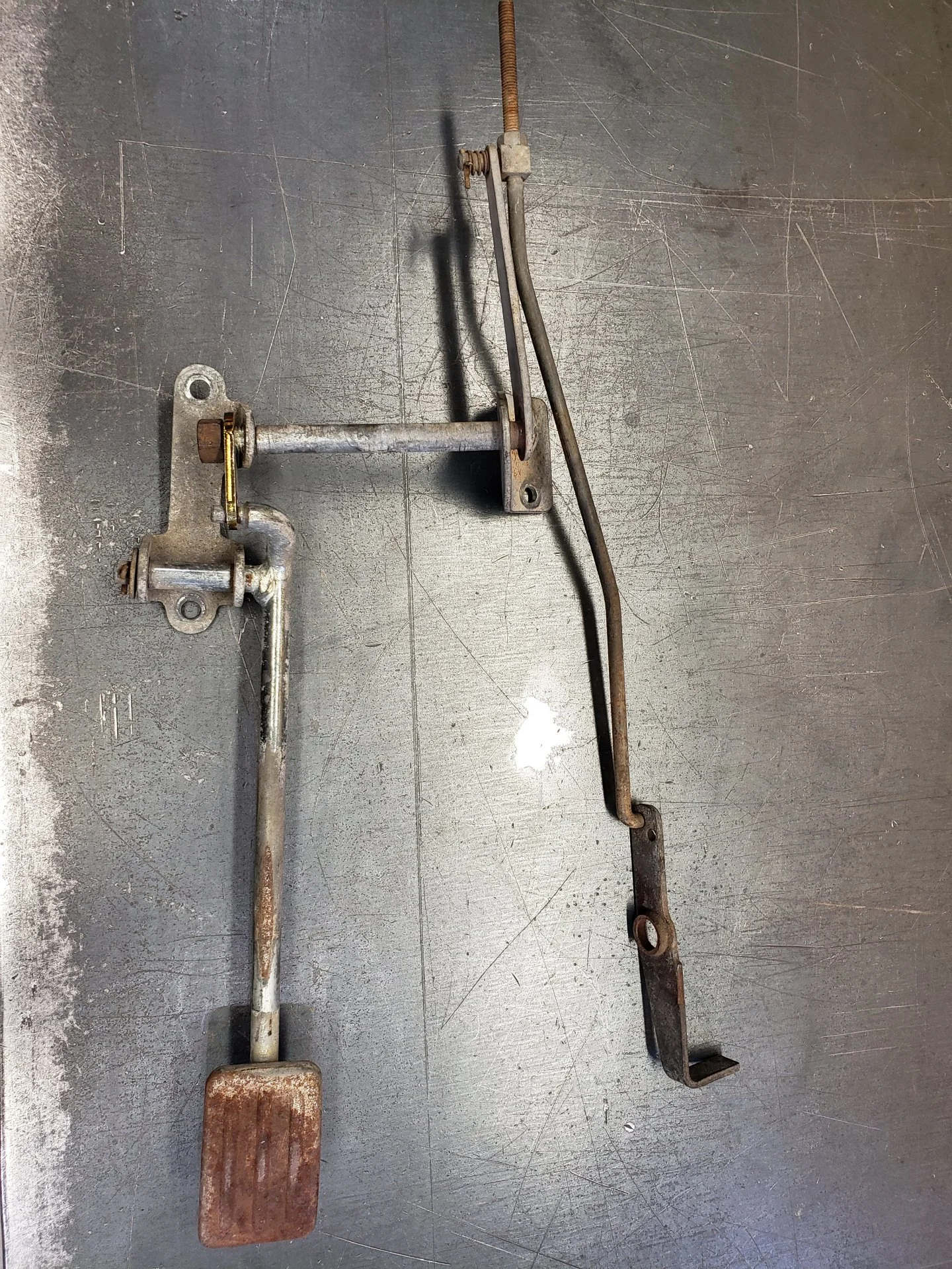

Have a 2F in a 58-67 FJ45.
The original linkage is "push/pull" (see below) The 2F carb linkage however rotates to control the throttle with a rod that extends from the firewall to the carb.
How did you convert one to the other? I dont want to drill any holes in the firewall.

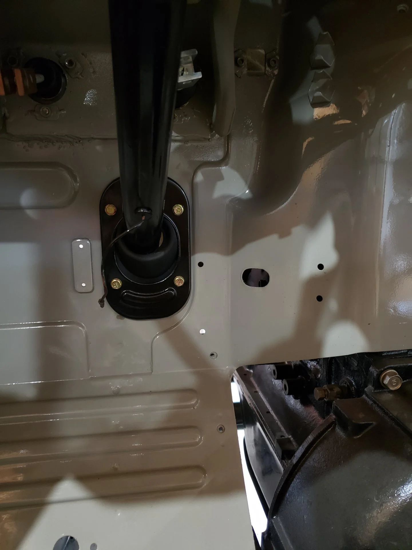

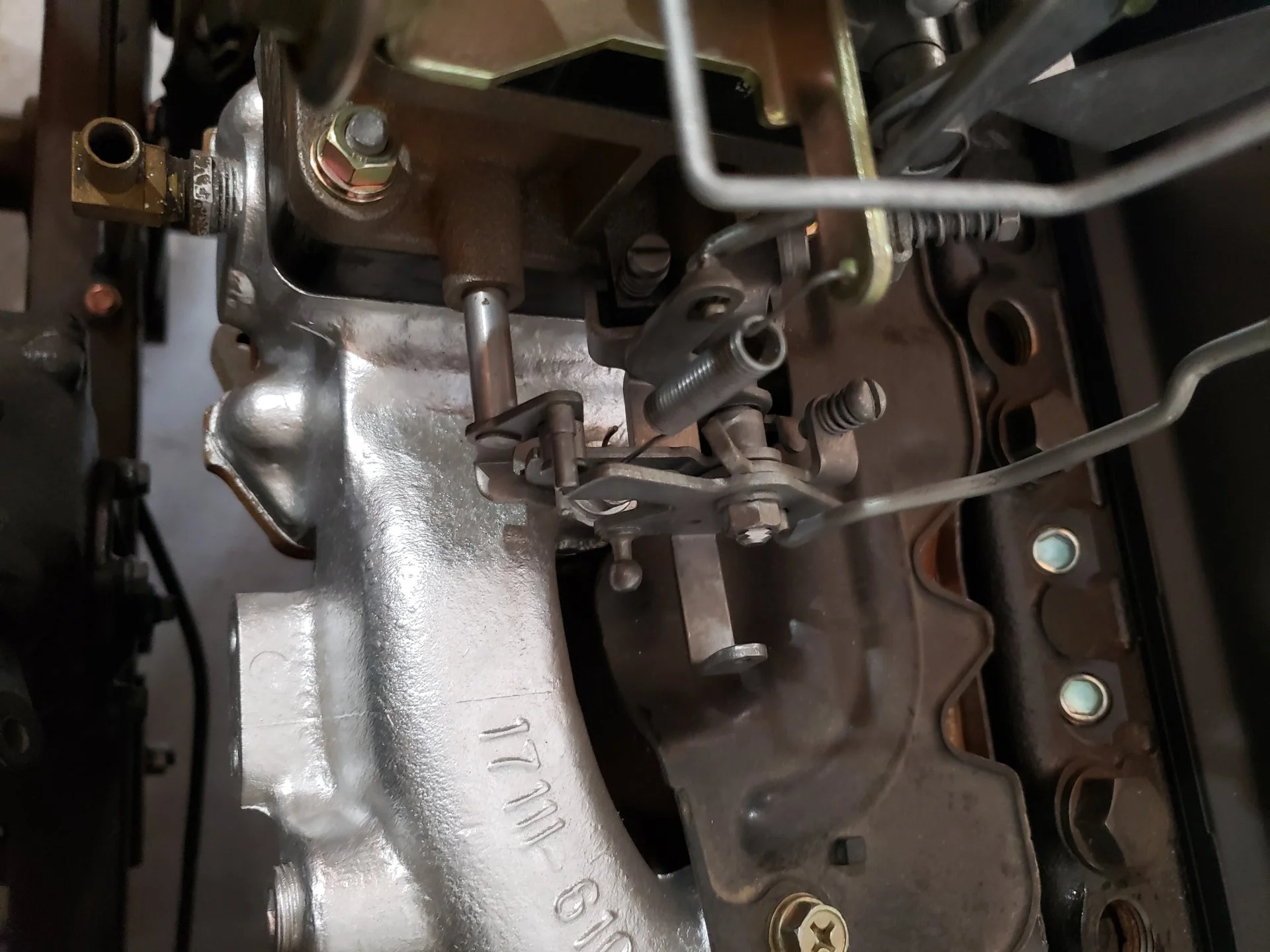

Here is a pic of firewall and carb to confirm fitment
Since it looks like there were several linkage options for the 2F, which set of parts would I need?
