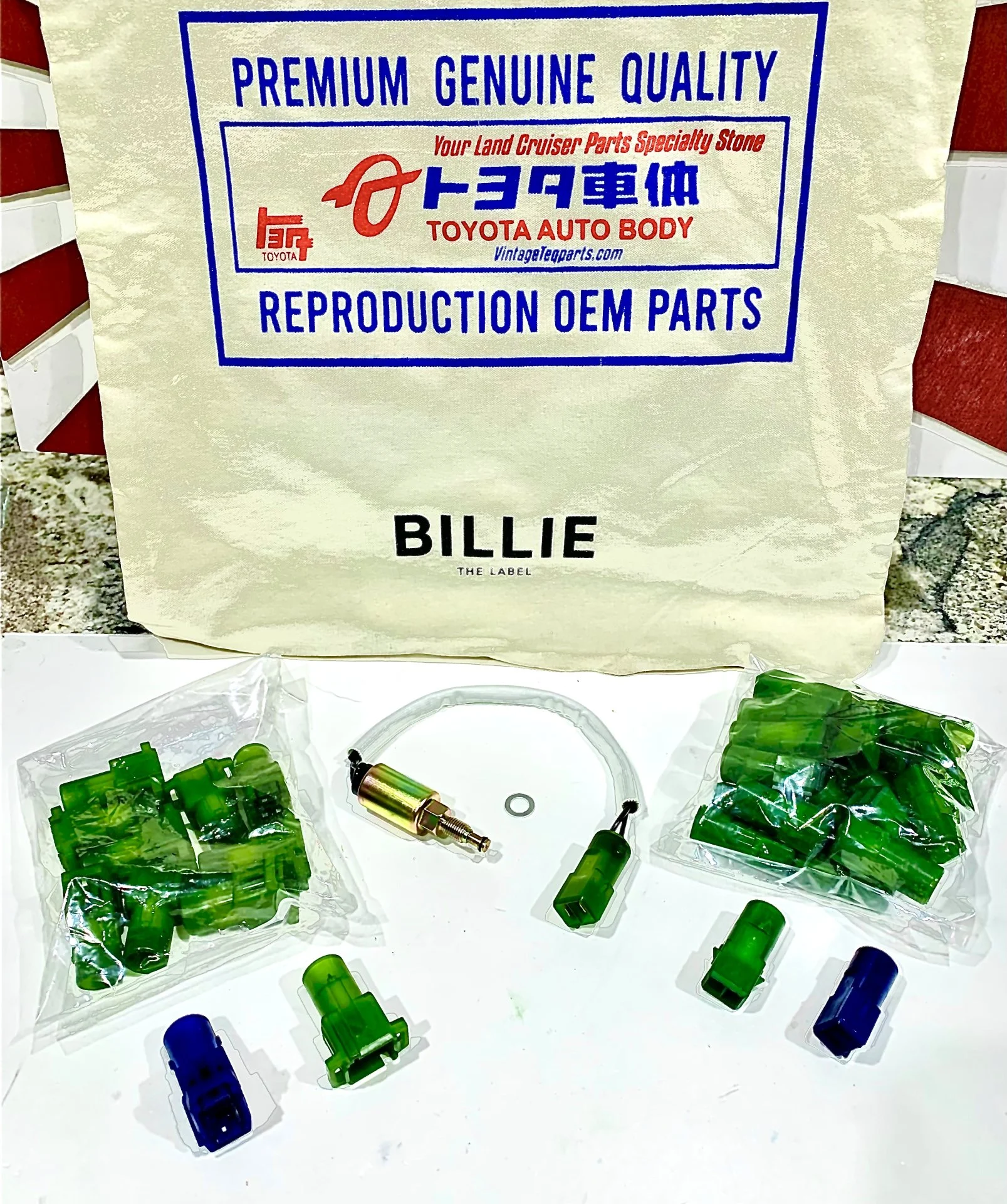

the harness side LH fender mounted location 2 wire green connector above is 100% correct for ANY 1/79-9/87 2F engine / 2 wire fuel cut solenoid ...........
fyi , since we on the TECH. Topic here in TECH. : :)

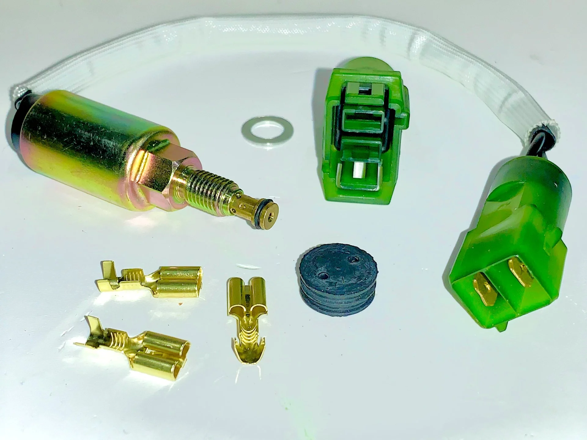

- My 2 wire 1/79 - 9/87 2F OEM JAPAN made FCS / Fuel CUT Solenoid comes with pre-installed ( of course ) with the 100% period Correct 2 pin male splash proof connector , correctly polarized as well / the b+ key on signal in the correct terminal bay and the dedicated Ground NEG - wire signal to the other correct terminal Bay
- my FCS is also loomed / wrapped with 100% fire rated / fire proof JIS cloth weaved looming jacket , exactly like thew originals were
- comes with a factory aluminum updated CRUSH RING Washer Gasket also ........
- Failure to install a new one or one at all will simply cause a fuel seep and or leak under pressure sooner rather then later in the short term and nobody wants this scenario , i hope ?
- NOTE : ANY 2F Carburetor 1/75-9/87 application CAN update and or UPGRADE to the Later Correct 2 Wire FCS , providing they have the HARNESS Side Mating Matching Profile Connector Housing , so of RIGHT NOW , ALL 2 Wire FCS 's i offer and ship out NOW come with the Correct 2 Wire Connector Housing , Black rubber back end plug or seal boot , and 3 female Solid Brass Terminals / one added for practice and or a mis-crimp
- i am not aware of any Vendors of any kind Globally that can and do offer a
NEW & Period Correct Part # 21062-61060 Fuel Cut Idle Solenoid ?

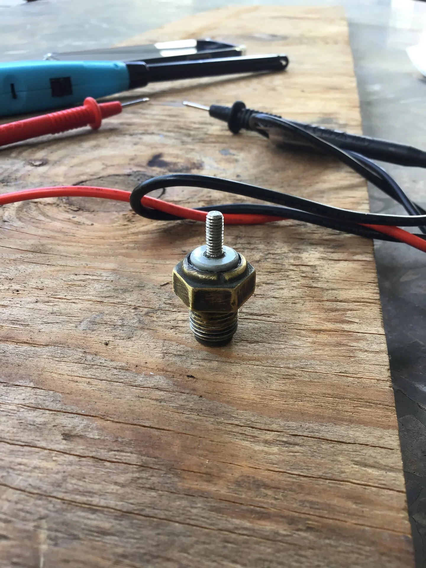

Hi- I think I have a bad themistor (not sure if that’s the correct part name.) for the cooler fan on a 88 FJ62. I ran the truck for 30 minutes and the fan didn’t turn on when I shut the truck off. I tested this part in hot water and using a lighter to heat it up, but there was no continuity between the post and the other end. I can bypass this part and activate the fan. is this part available anywhere or do I just need to permanently bypass to a ground? Thank you, Tom
That part is long gone. There was a thread where someone found an aftermarket substitute that seemed to work well. That or good used if you want to keep it tied to manifold temp.
I think it closes at about 180* or so.
